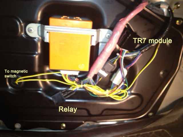

Well I got a 3rd gen (2000 limited 4x4 in Millenial Silver) for my son and we did he same hack to his truck. Here's a link to the youtube video: backwindow hack 3rdgen - YouTube

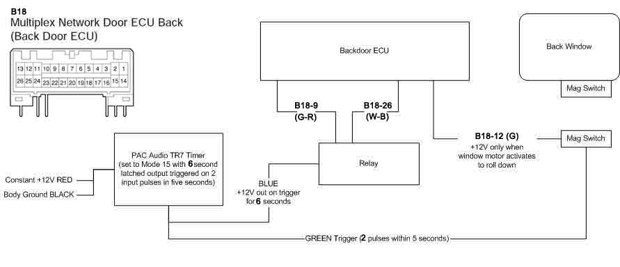

The hack is basically the same as the 4th gen, except that the wiring connections are different (due to the different wiring harness on the back door ECU for the 3rd gen) and I used a six second latch-hold time for the output of the PAC Audio TR7 timer, since it seemed the back window on the 3rd gen took a bit longer to go all the way up compared to my 4th gen.
I've attached a wiring diagram and a picture of how I packaged it all up. Hope you like it. Enjoy.
