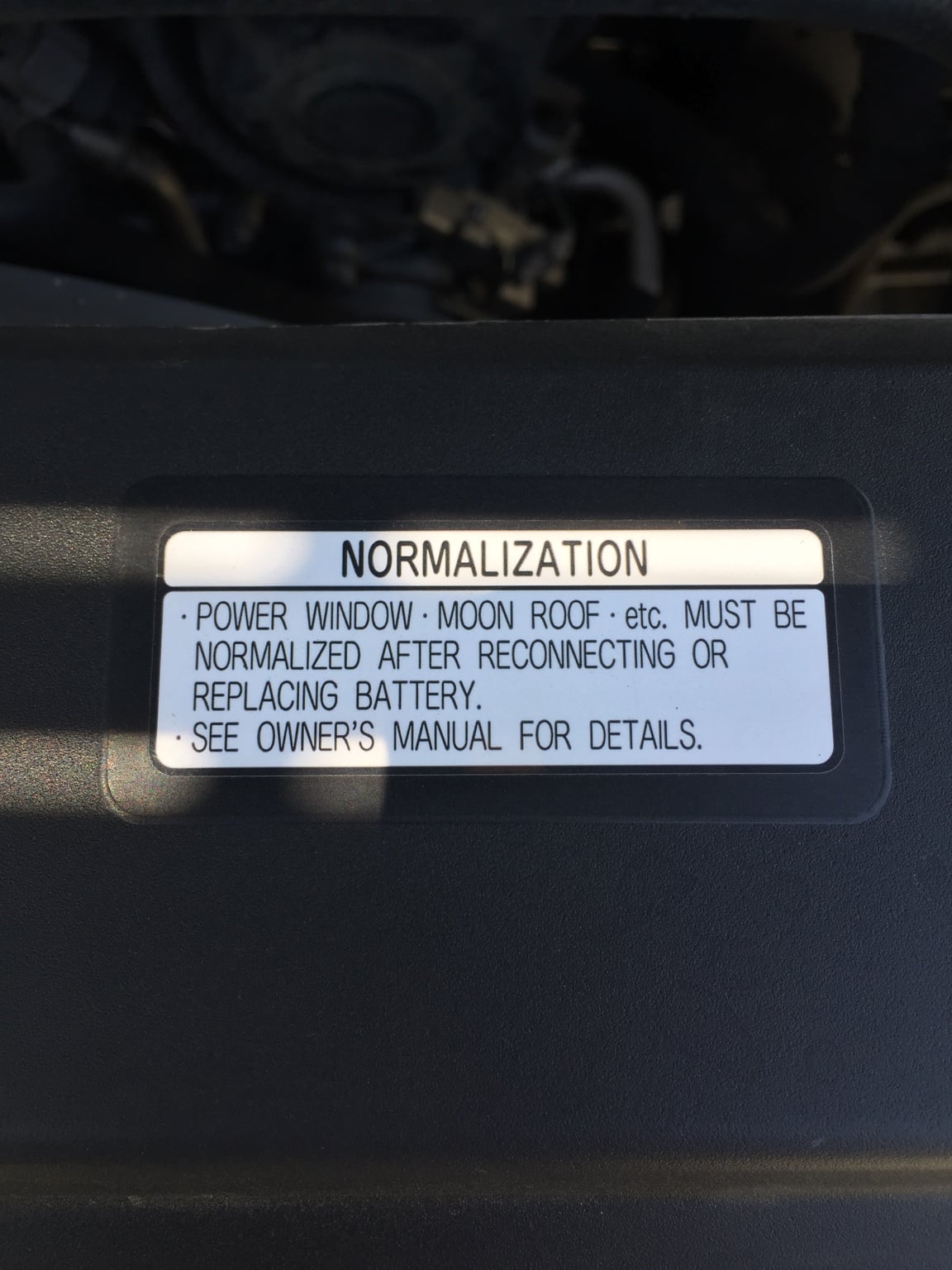

"Normalization"
My battery died on me and when I changed it. I noticed in the engine bay area it had this little message part of the plastic cover.
At first I forgot about the little note and was like "damn I just fu**** something up, the only I did was change the battery" lol
Then I remember the message.

we have a jump box here at work, with a 12v adapter. its specifically meant to avoid situations such as this.
I used it when I swapped my battery out, it worked great.
turn the key ON, plug in the adapter, and make sure the jump box is on, then disconnect the battery. you will need to take care not to touch any cables, as there is still juice in the system. but, this way, there is never a loss of power, so no need to reset anything.
