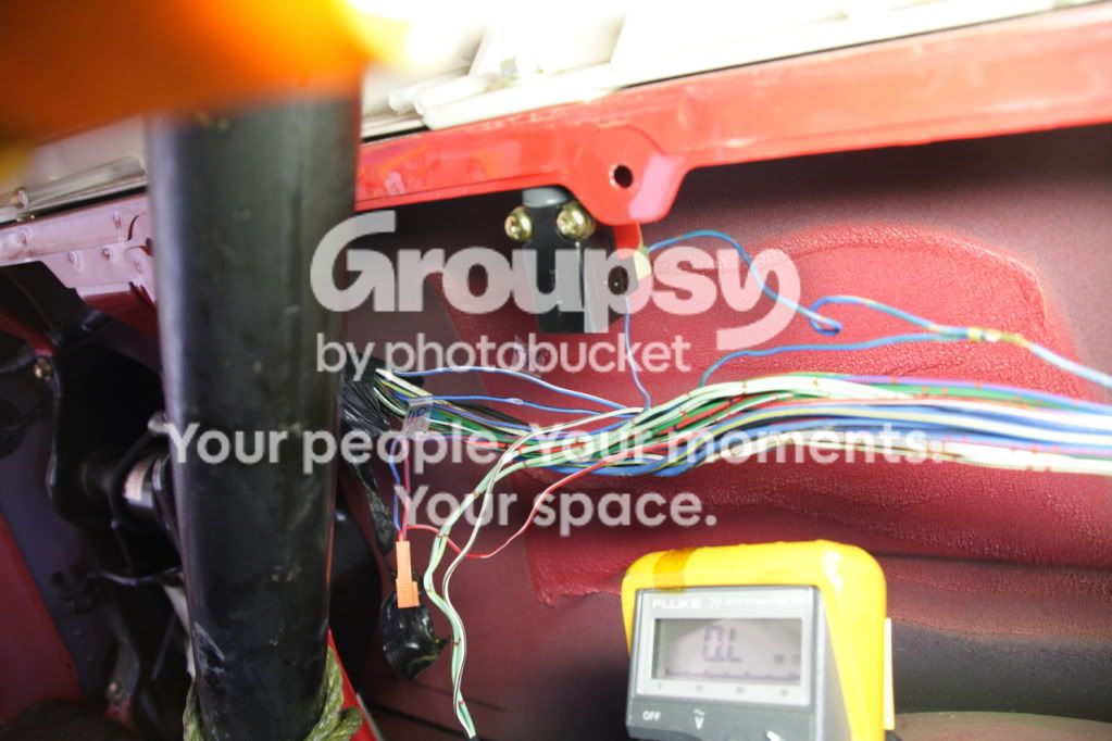

Location:
Cover_Top_Bolt_B_zps6916ddb6.jpg~original
Bolt should be proper length to close contacts of this switch:
20120819_017.jpg~original
If that doesn't fix it, also check to make sure your wiper is parked and contacts of wiper retracted switch are open = one of the contacts should have no continuity to ground.
