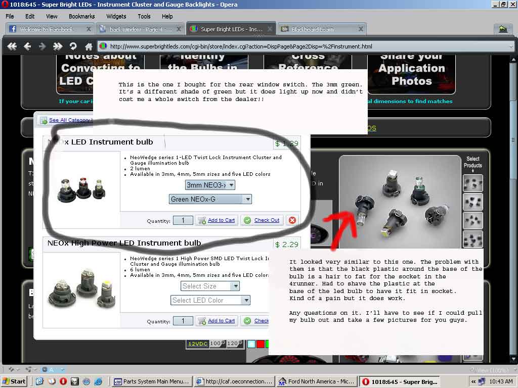

This might help you for the rear window bulb!
