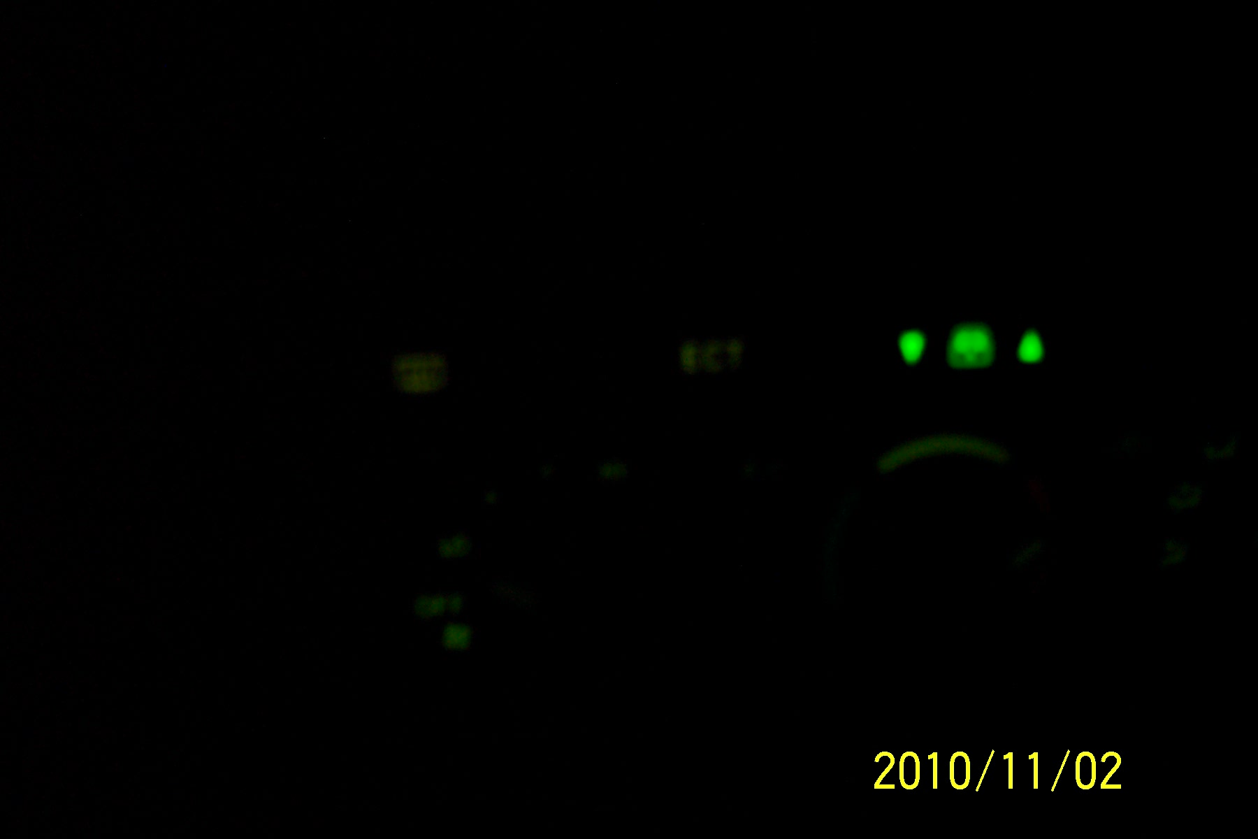

I took a pictures of it at night. Kind of S**tty pic but you can see that the led rear window switch is brighter then the ECT ones. It's a shade of green off from a normal filament bulb but still pretty good.
Hope this helps.

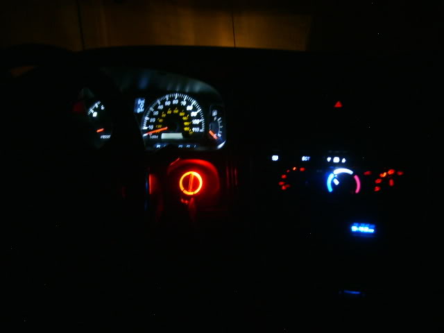

when you take that strip out that has you ECT button and rear window. you can actally take that cover off to exopse the circut board and it makes taking those bulbs out a lot easier as well as putting the new LED's in. You can still plug it in and make sure they all work before you put it all back together. some of those NEo-Wedge lights are Poly-something which makes it so they only work when you put them in one way. Autolumination will tell you which sizeyou need i think its (type A) but dont order from there though, get them from superbright LED's or another site I still have a few from autolumination that still work and its been almost 2 years, but i had those two (ECT and rear window) burn out on me within a year. here is a pic of mine all on
Your talking about Polarized and Non-Polarized bulbs.
LEDs are usually polarized. If they don't work one way, flip them and try again.

As for the neo wedges i think they were like $2.99 a bulb (online). There are only 2 bulbs that go into the strip. One splits the light into the defrost and ECT and then there is one that lights up the rear window button. They are Type A (t3)
the type B's go in your cimate contol. Now when you get them, someone already mentioned this, but the LED's are a little bigger but they will fit and work i didn't have to modify the bulb i just had to take that stip thing completly apart amd get it in there
Piperoo
here is what i ordered this is recently so they should be right
you will need 3 #24’s for the dash
#74's for the key ring, and shifter
2 Neo wedges type A, (t3) (Buttons)
3 type B (t4) (climate control)
