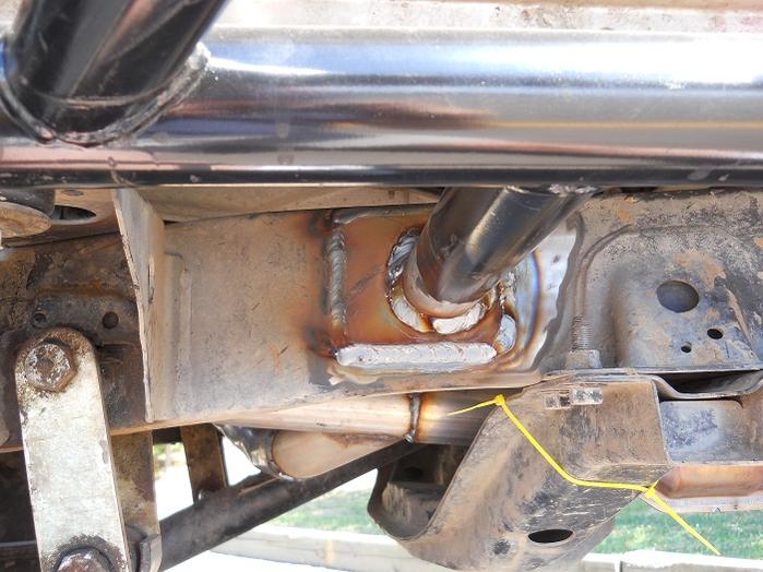

By the way, rocksliders weld to the frame correct? I'm alittle uneasy about that, doesn't welding stuff onto the frame make it weaker?
I had the same question when I first started thinking about rock sliders. I wouldn't worry about weakening your frame, folks weld sliders to their frames all the time and don't have any trouble at all. Bolts are going to be weaker than welds, and I'd hate to have one break and shove the sliders up into my rocker panel. I'd rather weld on my frame than drill holes in it anyway. As long as whoever has the welder knows what they're doing, I wouldn't sweat it.
That's why you see people weld plates to the frame where the slider tubes will mount--it beefs up the frame at the most critical points.

Ahh, welding plates. Of course! Thanks for the pic.. Visual aid is always good ;)
