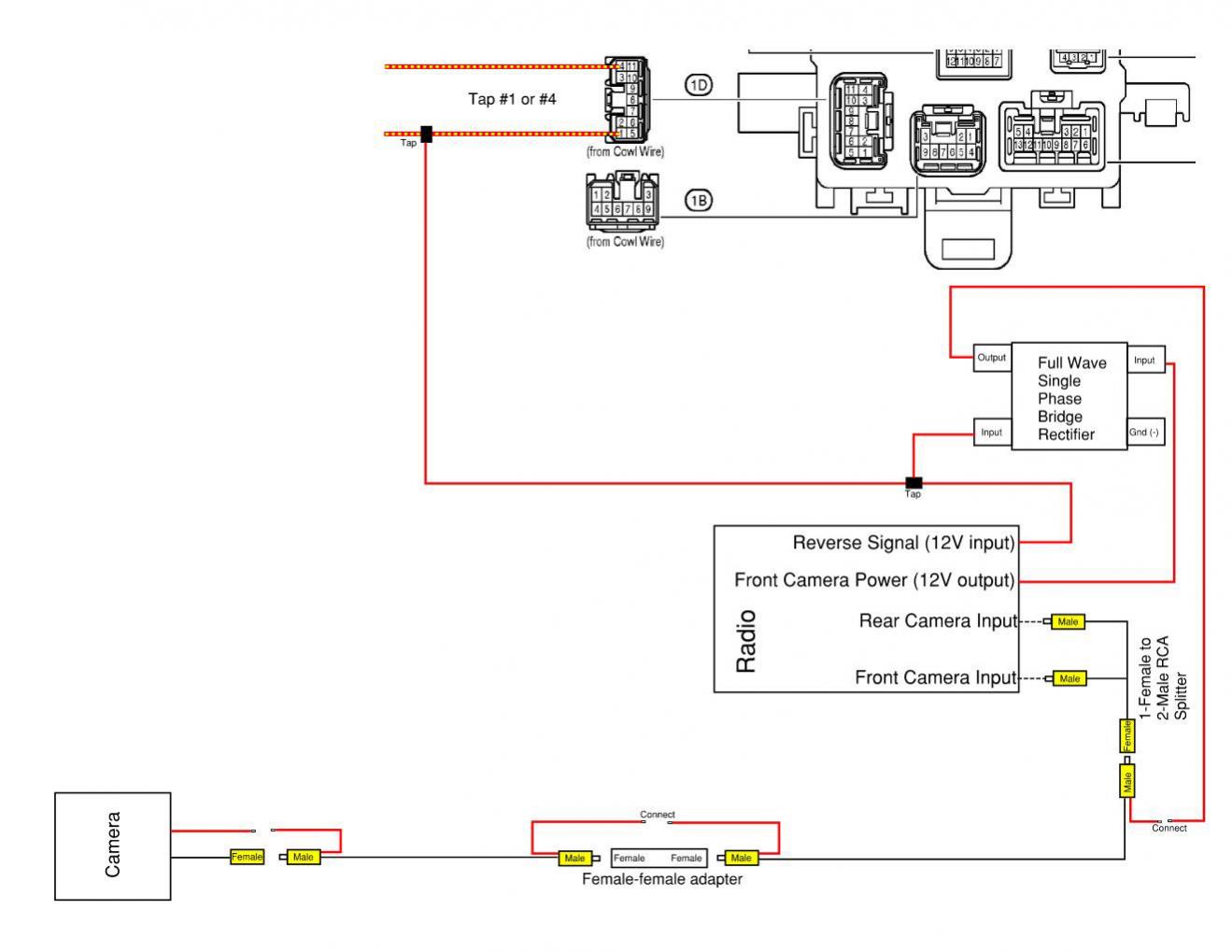

Attached is a wiring diagram I made up when I wired my backup camera. My particular head unit didn't have the option to turn on rear camera on demand, but did have a front camera on demand option. I used a splitter so that my rear camera fed both the front and rear camera ports on my head unit.

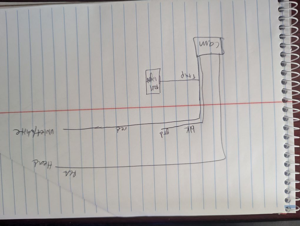

Is this wiring diagram right? just splice in the red wire from the camera to the tail light, black to ground (probably leave it near the hatch door to not require a long wire run) then RCA in.

That will work to ONLY trigger the reverse camera in reverse (it will leave the camera unpowered if you try to view it when not in reverse). You can also find the reverse wire up under the dash - it is a red with yellow tracer wire. You can find it in/near the connector that connects to the harness that runs to the rear on the driver's side, and up in a junction connector behind the fuse box there (if you have an auto trans). Obviously check with a multimeter to make sure you have the correct wire before connecting the camera to it.

yeah i realized that after I hooked it up. That's fine, I've driven for 20 years without one so I only care about looking down at the bumper when backing into a tight space.

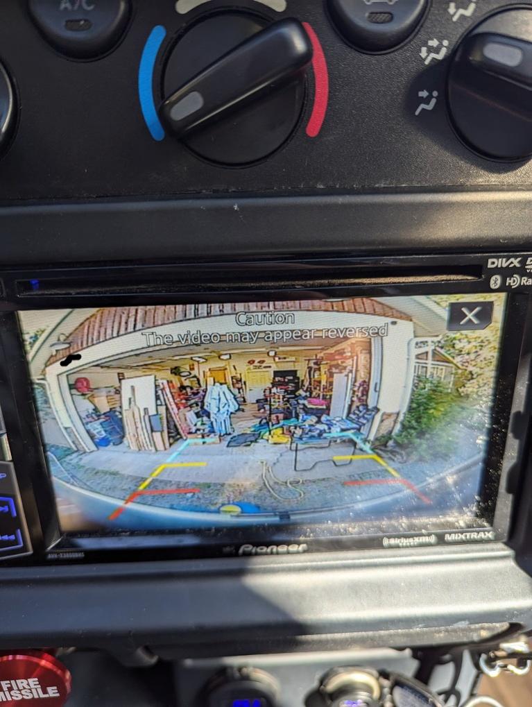

after a week of use I'm actually not quite happy with it. It's not wide enough. I can tell what's 2' behind me at the very closest but it's not zoomed out enough. Could be because it's on the license plate vs above like on the top of the rear hatch. It's also from 2015 when I bought the runner so it might just be a crappy old camera style. It was just sitting in the shed all these years.
I'm debating getting a NATIKA style one and maybe mount it on the hatch top near the third brake light so I can look down at the bumper/hitch and see all the sides since it has a wider angle. I tested it out and I backed up today and purposely hit the curb with my tire but couldn't see the curb on the camera at all. so....darn.

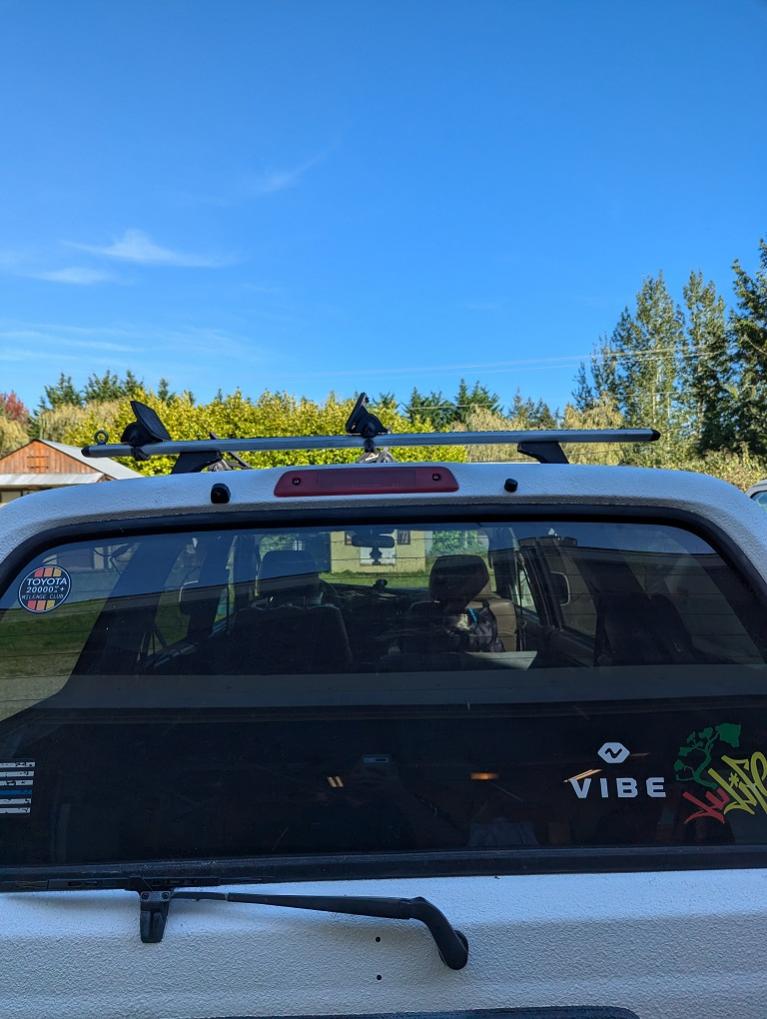

I ended up getting the NATIKA style one, installed by the third brake light so it looks like an OEM mod, symmetrical to the rear windshield spray. I will say.....it was a HUGE PITA to do it that far out because my through-socket is only 5 inches long and you need to get the nut on the threaded bolt on that camera and there's no other way. and the wire got twisted up around the tool, must have taken me another 45 minutes just getting the tool back out. But wired it through one of the seep holes in the hatch shell and right down the rubber boot we're all familiar with. As a tip, I just slit the rubber boot and shoved the wire down real easy. Followed up with liquid electrical tape and regular tape so it's solid. image quality so much better and with that style, I can cut one of the installation wires so the image isn't reversed but rather straight on. I love it.
