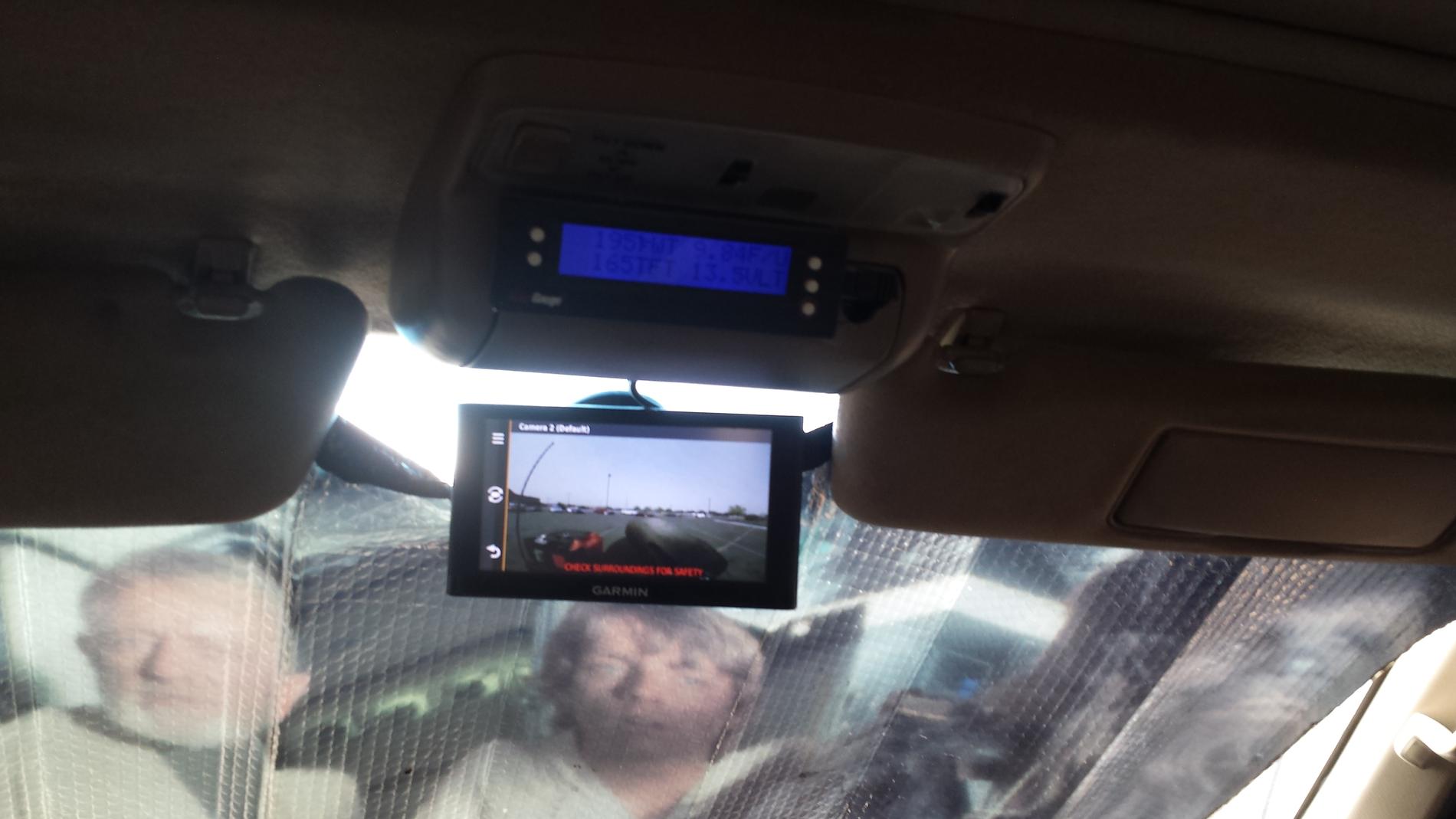

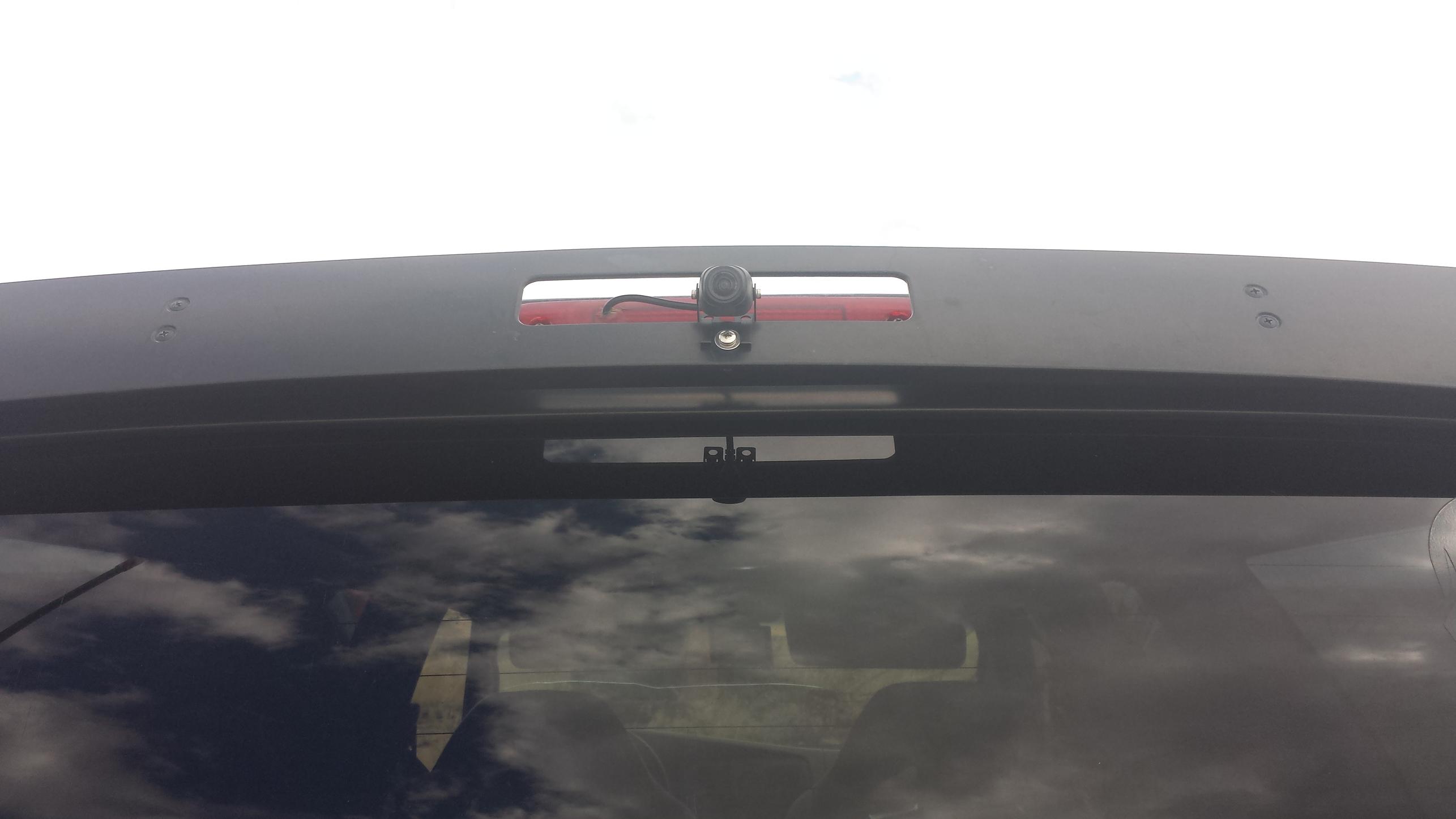

I'm using a Garmin nuvi 7".replaced the mirror. Mounted the camera in the third brake light opening in rear spoiler. Instead of hooking back up cam to reverse light. Run it to a fused switch on the dash. For me it's power on ...rear view. Power off... gps. Good luck.
I like it, thanks for sharing. Another or my first thought was something like this (once I get a tire carrier) https://www.tadibrothers.com/products/7-mirror-with-120-rv-backup-camera
