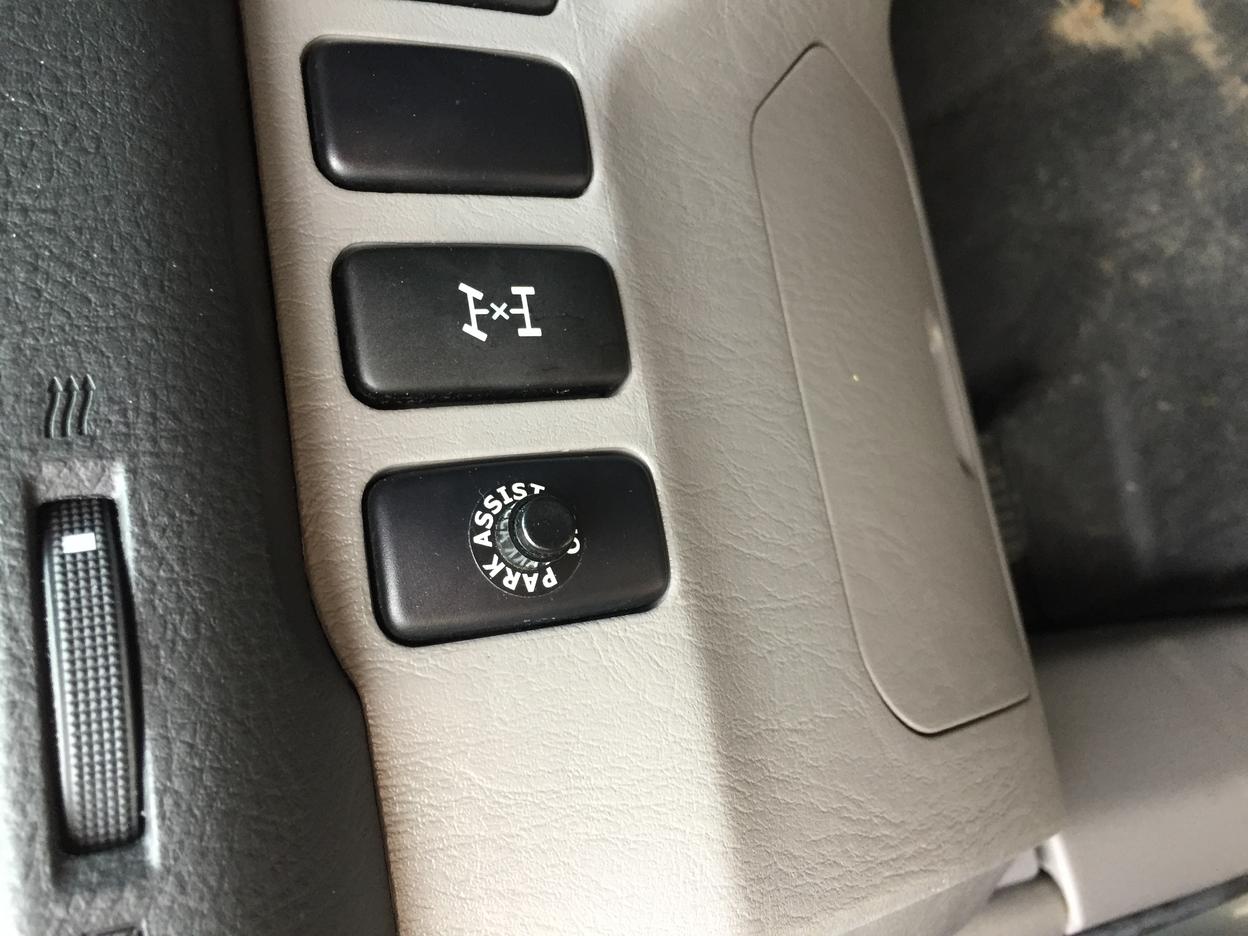

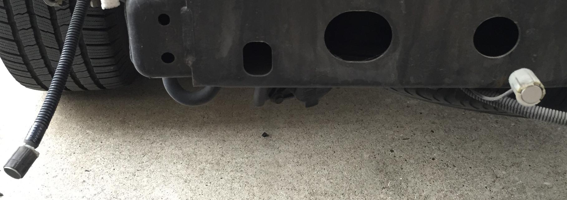

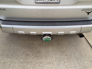

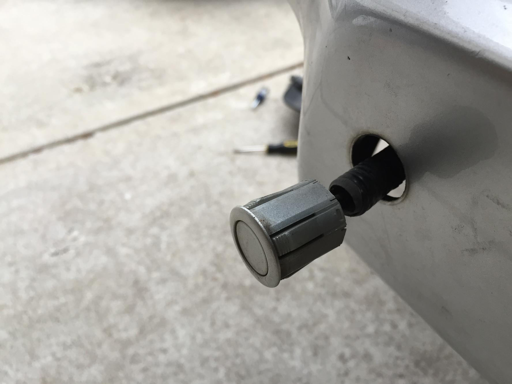

Funny, I was working on my sensors saturday morning trying to figure out if they are OEM or aftermarket. One of my sensors had sun damage and popped out, broke the clip. I went searching for a OEM replacement but I guess what I have is an aftermarket setup. It looks OEM because of the on/off switch I have. So, I searched eBay and amazon and decided to replace with this http://www.amazon.com/gp/product/B00FQD5L78/ref=oh_aui_detailpage_o00_s00?ie=UTF8&psc=1
I'm hoping that I can just splice the sensors and use the same wiring that is already there. I do not want to rewire and lose the function of the on/off switch which looks OEM. If it doesn't work, I'm out $17 and I something to cover the holes with.

I installed the new sensors I bought from Amazon and am really pleased with the results. The color matches well and my splice job worked. Boom!
I put the indicator lights in the garbage, all I wanted to do was replace the broken sensors and keep the on/off button. I didn't want to rewire everything. I have a backup camera so didn't need the indicator lights.
