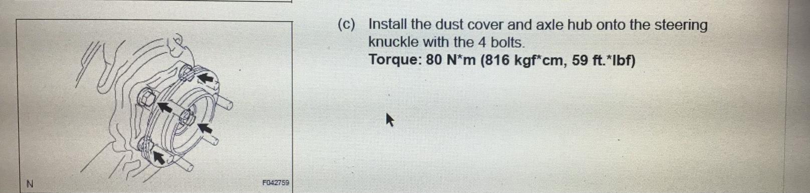

The 4 bolts that hold the bearing to knuckle are torqued to 59Ft# but its impossible to use a torque wrench even with a crows foot. Use red loctite and tighten it as much as you can.
