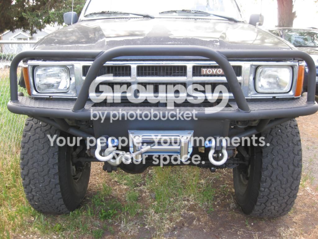

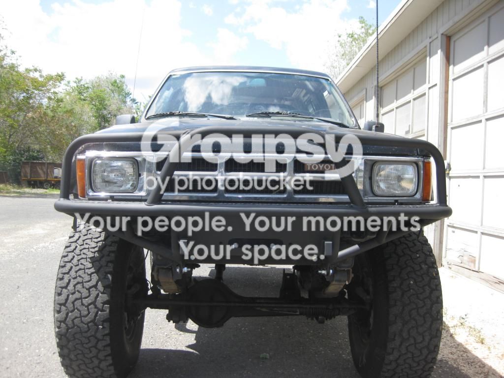

im not sure about other years, or other winches, but I had to remove the grill to get the winch in place.
im using a rugged ridge 8500. its 6" wide. it was close, but wouldn't go with the grill in place.
also, its not impossible to mount after, but I think it would be easier to mount the roller fairlead BEFORE installing the winch.
oh yes, another thing I forgot mention.
my roller fairlead doesn't match up to the cutout in the front.
i'll drill new holes and adjust it up slightly. its only off by about 1/2"
I mentioned this to jeff, he said they cut the bumpers for use with hawse fairleads. that they prefer that style since they don't get as damaged when ramming things with the bumper lol.
he said that he would address that point on the website.
so just a heads up, to mention which style of fairlead you plan to run if you order one.
also, he really liked my added bracing for the top plate. it sounded like that may be a standard feature on future bumpers. I think this is a good idea, as it is very solid now, to match the rest of the bumper.
the final product.
with the winch mounted.
IMG_0335_zps793139c6.jpg~original
the rest of the write-up and pics are here.
http://www.toyota-4runner.org/class...wheeling-everything-thread-2.html#post1685334
