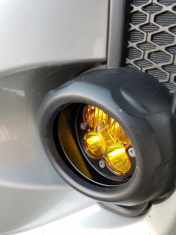

Does anybody have the fog light kit made by Baja? Can you post a close up photo of it? How big are the gaps?
Also, will this work with the Limited fogs? Lastly, I'm assuming the Squadron Sport lights are for off road use only, correct?

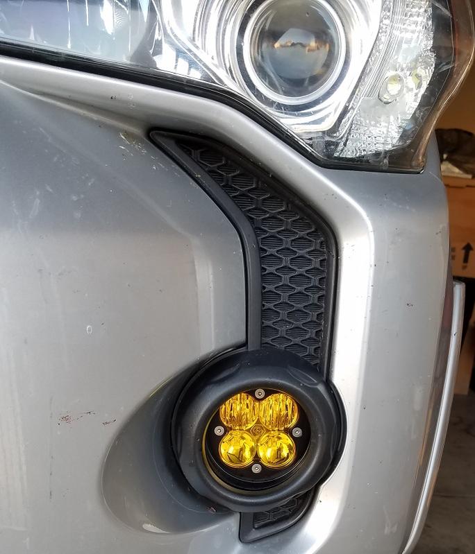

I have them, and then when they came out with the fog surrounds, I installed those as well. I was probably one of their first orders for the fog surrounds. Fit is fantastic.
Here 's a photo:

As for fitment, the angled bezels fit the stock bumper very well for a clean look. They really hit the ball out of the park with this one...

As for gap, you actually need to have some so they can be aimed properly. If they were truly flush they would probably be pointed too high and blinding other drivers. I still occasionally get flashed, but it's rare and usually only by someone coming uphill at me.
