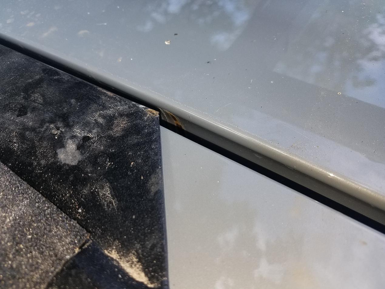

My ladder is holding up well! I use mine pretty regularly for loading camping gear and jerry cans over this past month, but do have some cosmetic wear on the top of the ladder where it meets the back hatch. From what I can tell it rubs with the body when I open the back hatch, and has caused the powder coating to rub off. Ill take a photo later to show this. Very minor, and the ladder has been holding up flawlessly since installation in early July. Foam pads and all.

Here is my rub. Hard to get a good angle. There is a minuscule rub on the driver side too, not chipping, but there which tells me that the ladder is in the correct place as I thought it may just have shifted to the right.
I will be taking it off this weekend and filing down the bent edges where it is scraping and then touching up with rattlecan bedliner... as for the truck, I don't think I need to spend the high dollar for color match when it is d@mn near impossible to see it anyway so I will be touching up with Rustolium grey off a paintbrush.
Thanks for asking about this as I probably would have missed it for a while too long. The whole truck was covered with mud/sand after this weekend and the photo is from this morning after its first bath haha but at least I caught it now!

That's some good real world feedback. Thank you for posting the pic. Shaving the corners down looks like a good fix. It might be worth passing on to the vendor, not sure if they are on here.
