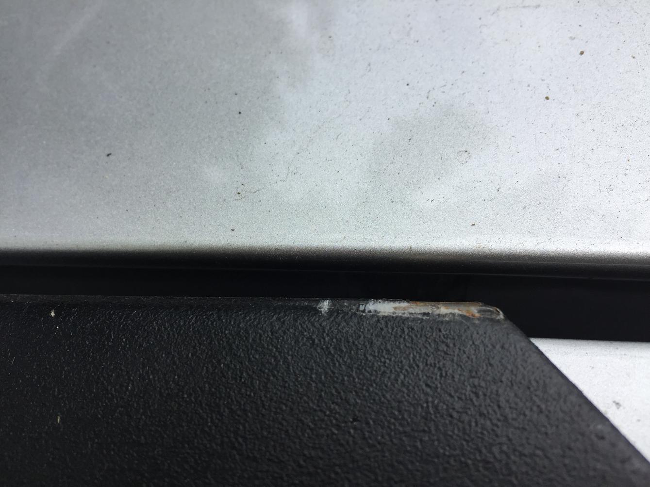

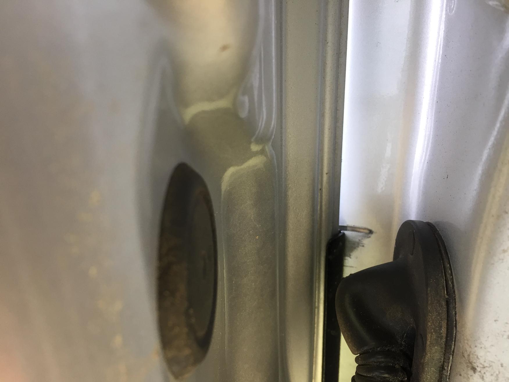

The same exact issue I have going on with my ladder. Definitely a hard area to reach for touching up, and I'm not sure how I'm going to handle fixing this issue yet.

Thanks for the pics and replies guys, it's unfortunate that these ladders rub however it looks like a minor tweak in the manufacturing process would take care of it.

I would definitely stick with my Baja. Aside from the rub that I am now aware of and can fix with time an a file, I still like the look better. A ladder is a ladder either way, so I mean, how much is there really to say about it.

I talked to Luis today at Baja and he says the latest ladders have been modified to address the rubbing issue. Specifically the top corners have been shaved down.

After further review of the pictures, and sending a few to Baja, they say that the current design (with the corners cut off) is good. They say it is an installation issue.
The tip was to pull the ladder back all the way prior to tightening the lower clamp. Just an FYI. The service dept. has excellent communication.

I have to disagree, respectfully. The communication from BR has been less than stellar. This is clearly a manufacturing issue, even with the new design. I have several emails out to Bajarack, dating back to June, with no response, except for "installation error". I re-installed 3 times, and the inboard corner continues to protrude. I really wouldn't be upset, except for the fact that the ladder damaged the hatch paint and dented the hatch frame from rubbing. I really didn't want to come on the forum with this issue, but I requested to return the ladder and have received no response. So it sits in the box in the garage and I am sad. Buyers beware.

Thanks for letting us know this tidbit. Mine seems to move when subjected to miles of washboard; causing the rubbing. A firm yank back to seat it onto the rear hatch has, for now, fixed the issue. I may try re-installing it before my next Baja trip and see if indeed it wasn't firmly attached on the initial install.
