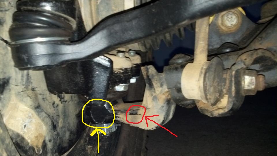

I did the Taco LBJ's and OTRE's and I'm experiencing all the good drivability except my turning radius is much larger than before. When I turn now, I only get 1.5 turns of the wheel from center before I hit the steering stops where I should get 2.5 turns and a much tighter circle. No big deal on the road, but it could be a heckuva big deal on a tight trail somewhere.
In the picture, the yellow circle hits the red circle at full lock. It almost hits the sway bar link, but hits the steering stop just in time. I don't think its possible that I put anything on backwards...but if you've got an idea then please share!

Fonerunner, I think that is pretty common and why I'm sticking with 4runner ball joints over Tacoma ball joints.

I thought about it, and bluntly put, while I may do some occasional off-roading, and while I will end up lifting this thing (trust me - some of the places I have to drive, it WILL get used lol), I don't plan on doing any serious technical stuff with it; so the larger turning radius is nowhere near as much a concern for me.
You can always grind the stop back by 1/8" or more on the LBJ to give you back the turn radius. It won't hurt anything.
