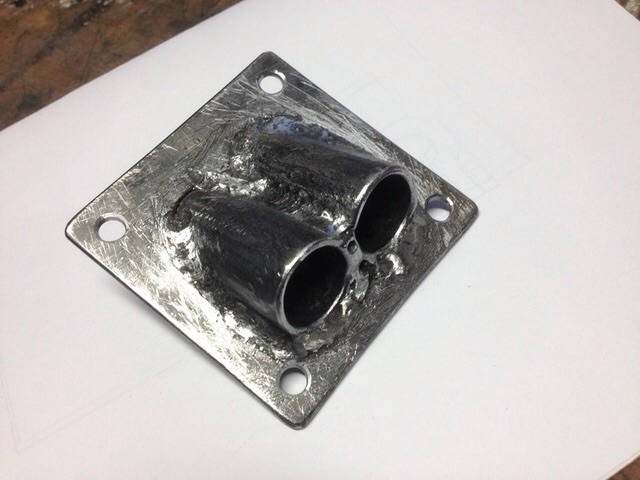

Got a little work done on the inverter install. The inverter will be located under the driver’s seat, but the power cables are too large to run through the firewall and hide under the carpet. So I’ll be running the power cables from the battery down under the truck, and up through the floor of the truck. I needed something to protect the power cables as they came through the floor, and also seal around the cables so no water could enter the truck. So I came up with this:
Basically a plate with 2 tubes passing through at an angle. The plate will bolt to the underside of the floor with a foam gasket to seal it. The cables will have a foam gasket wrapped around them and will be forced into the 2 tubes for a tight, leak proof fit. Here’s an example of a cable passing through one of the tubes:
IMG_0417_zpsun9uatj4.jpg~original
IMG_0418_zpsufzi5rty.jpg~original
So once I had that figured out, I needed to cut a big hole in the floor of the 4Runner. I cut it just behind the front seat mount, right next to where the inverter will be mounted.
IMG_0420_zpsutg3wuhc.jpg~original
Here’s a pic of the plate mounted to the floor from underneath:
IMG_0421_zpsi46jd0q0.jpg~original
That’s as far as I got, for now.
I already said it, but I wanted to in this thread, Congrats on T4ROTM! Well deserved and long time coming.
Now on this inverter pass through, I really like it! I just got mine done and ran the wires under the center console then out and under the driver seat. It is not my ideal setup, so I may borrow this one from your book too.
Our engineering department is always looking for some talented and highly skilled engineers. We have one from MIT and another from Stanford where you could teach them a thing or two I'm sure. Your use of CAD is exceptional from concept to finished product. I really enjoy reading and "seeing" what you're thinking as you go through the inception stages. Congratulations to you [MENTION=55891]Bandit Runner[/MENTION] for the award and thanks for giving back to this community of T4R addicts. :trophy:
Wow, Definitely one of the nicest comments I have gotten. Thanks so much!
As you can probably tell, I really enjoy the design process and the challenges of overcoming engineering problems with creative and innovative solutions. Its all about making things user friendly, functional, aesthetically pleasing, and fitting them into predefined space constraints.
Thanks Ripcord! I actually would have preferred to run the cables through the firewall and under the carpet, but they are just too darn big - over 5/8" diameter. That's why I went with this alternate route of running them under the truck instead, and having them pass through the floor right next to the inverter.
