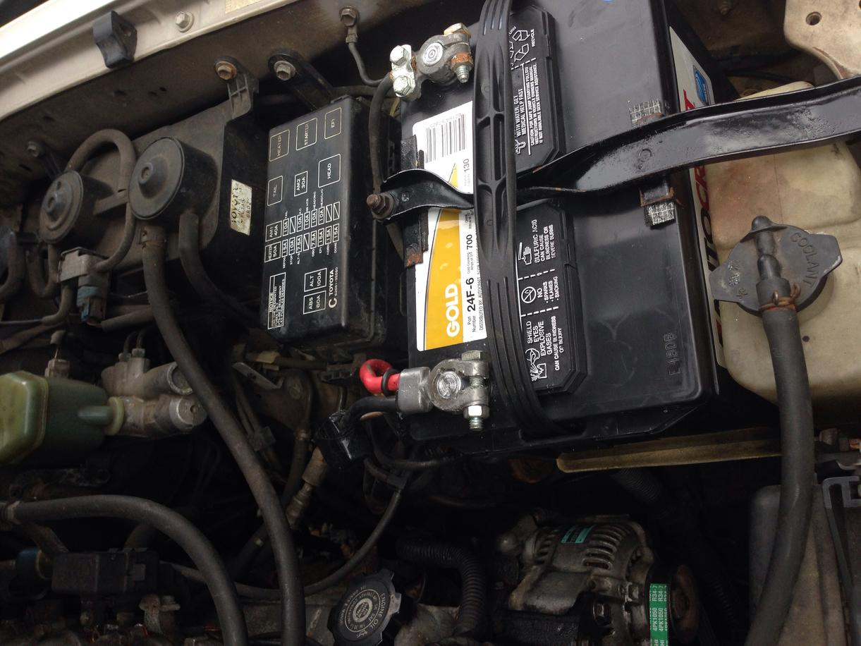

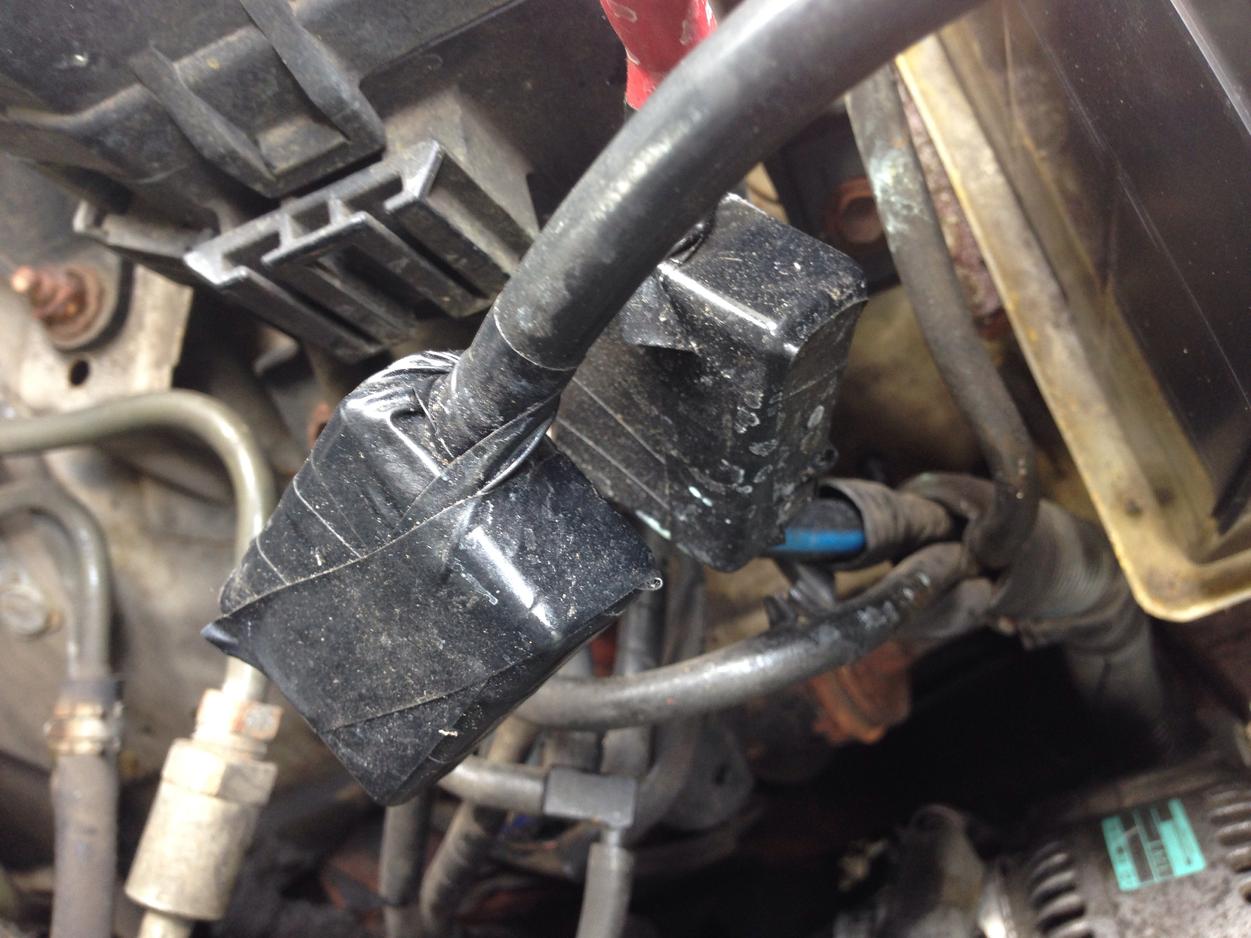

I have these 2 boxes on the positive side battery cables what are they? I will replace battery cables so do I need to completely replace alternator or can brushes be replaced for a fix?
I'm not telling you to replace the positive cable, at least now without proof of something wrong.
But I do recommend replacing the negative to chassis cable with 4G. It is easy, its only about 14" long and its right there. Replacing it will take 10 mins. Replacing the positive cables would be a lot more work and probably not necessary.

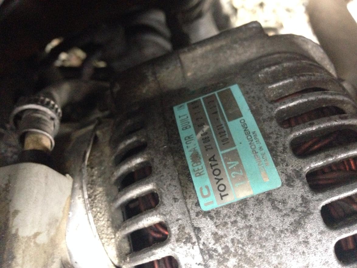

Can you take another picture but stand back 3 feet? Also take a picture of that sticker on the alternator.

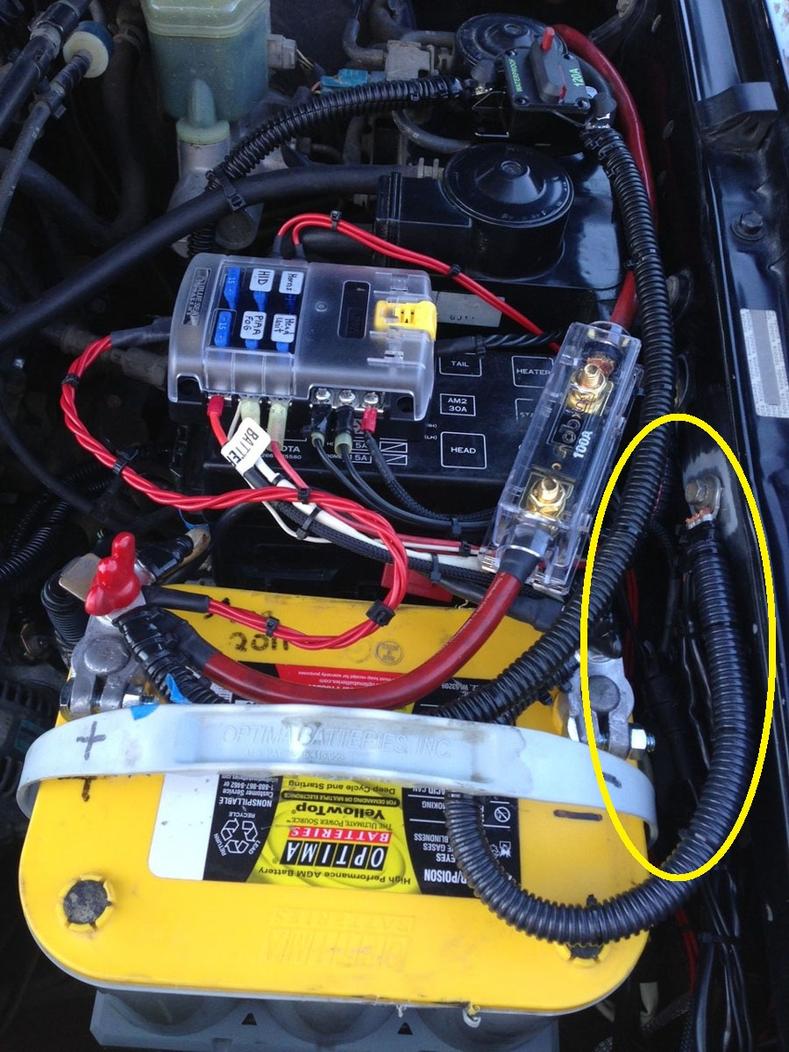

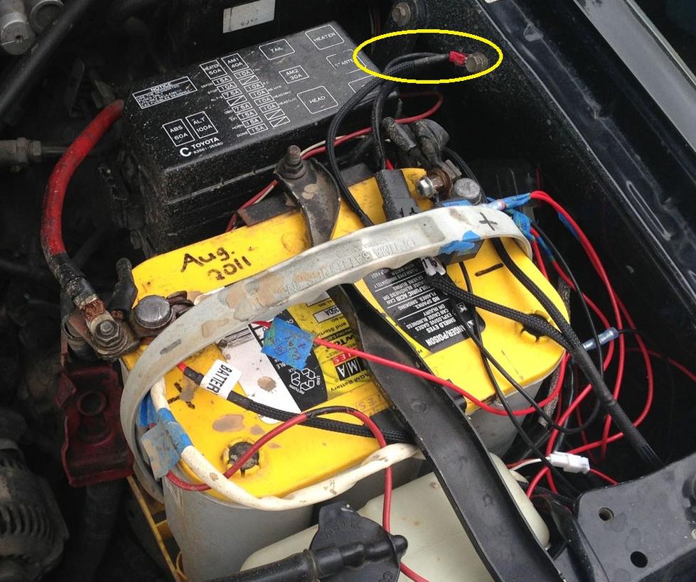

This is what I meant by replacing the battery negative to chassis wire.
Details are in my thread or you can Search for the "The Big 3 Upgrade" ; I'm not recommending you do the entire Big3 (yet) but at least start with the ground wire.
Pictured
Before - the factory ground is the wire that is barely visible, behind my stereo wire but it is there you can see how small it is.
After - real 4G wire

I opened the black boxes and they are just extenders to connect a new battery terminal wire. I have a 4g wire on order I will replace the ground side.
