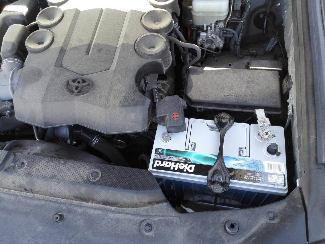

I replaced my stock battery (Panasonic) with a Diehard M31 Plantinum Marine battery at Sears.
If you decide to choose this type M31, you will need to buy at least one set of Remy Terminals (recommend you to buy 2 sets, in case it does not screw in well, you will have one more set to try) in order to have Plug and Play replacement. There is NO modification in extending the cable required.
You may also need to consider if you want to have a battery case (if you want to have a separate mount). I just asked the Sears mechanic guys to take out the old plastic tray and install this AGM battery in the same slot. It fits perfectly.
Sears offer FREE battery installation services (a coupon from their website).
That is simply freakin' awesome.....no need to make it harder than it needs to be or spend a ridiculous $100 plus for a battery tray/cage!
