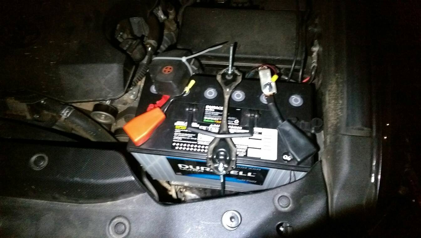

(Ignore the wonky j hook and no battery tray, just like that until the new tray gets here Monday)

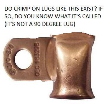

Does anyone know if crimp on lugs like this exist?: I want to try to get some torque off of the current lug connection
