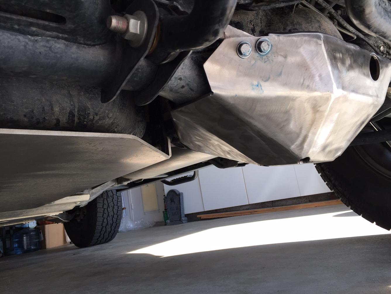

I have a '15 TE with KDSS. Have full RCI skids other than diff skid (RCI not available with KDSS). Wanted to know if anyone has RCI fuel tank skid with BudBuilt diff skid and if they both fit without modifications?
Any notching of RCI fuel tank skid necessary?
Contacted BB and they weren't sure if notching was necessary.
Answering my own question. Just went for it, since I couldn't get an answer otherwise, including Budbuilt, I purchased the stainless diff skid from Budbuilt and installed yesterday without any conflicts. Plenty of space between RCI fuel tank skid and budbuilt diff skid.

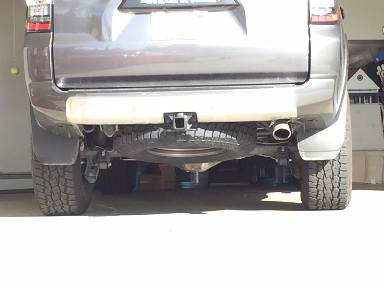

At the same time, put my new spare, 17x9 wheel with 285/70 17 Toyo AT2 tire in OEM spare tire location. Moving this spare tire to bumper swingout after install.

thank you for posting that ... I'm in the same boat... I have the RCI Fuel Tank skid and want the bud built or go full custom. Dont know yet but at least I know the Bud built one will fit...
