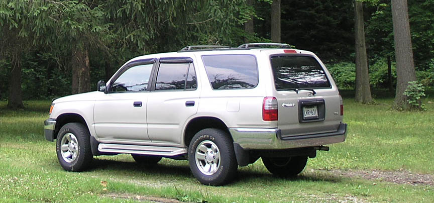

OK, I now have the bug. I want to upgrade some things and enhance others. Here's what I want to do - PLEASE help me with info if you have ANY info on ANY of these things. It will help enormously and save lots of $
1999 4Runner, 4Cyl., 2.7L, auto-trans, 125K miles
I have just installed new Bembo rotors and very good ceramic pads
Using synthetic oil
stock tires
What I want to do:
2" lift kit if I can keep the same smooth ride - what kind should I get?
True Flow Air Intake System ($220?) - will this help or make no difference at all?
Should I replace the rear axl seals? I hear it's about time after 100k miles
I understand I do NOT need to replace the timing chain at this point?
Should I use OEM plugs and cables for the next tune-up? Is there something better out there?
Should I get the transmission fluid changed? Brake fluid? Any other fluids?
Anything I can do for improved power with addons like the TrueFlow cold air intake?
Is there anything YOU recommend that I did not list?
What should I replace the running boards with? They are loose and rattle.

Has the timing belt been done before, they typically are done at 90k, if it hasnt then I would recommend getting it done.
LIFT - OME, PP, sonoran steel, or spacers....do a search on here to find what best suits you.
CAI- if appearance is what your after then go for it, if performance, then its not worth it IMO. Just get a true flo air filter and do the deck plate mod.
Rear Axle seals- if you want to go for it. Mine are fine w/150,000 on them. I think inside of the rear tires will tell you if you need to replace.
Timing belt- Highly recommended evey 90,000 miles. Have heard some last 160,000 miles...its a gamble and is your decision. Your ride and your money.
Spark plugs and wires- OEM is the best option.
Fluids- if you haven't changed them yet, change them all.
Power gain- Anything short of a super charger ($$$$) is not worth it. A CAI is not worth the money to HP gain. Search deckplate mod and it will give you as much if not more HP then a CAI for only $20-$30. As suggested earlier, deckplate mod and true flo air filter.
Running Boards- Toss'em. If you wheel then get some sliders. Do a search for sliders and find the company you want to go with.
Above is my opinion. those that might not like it... so be it.
