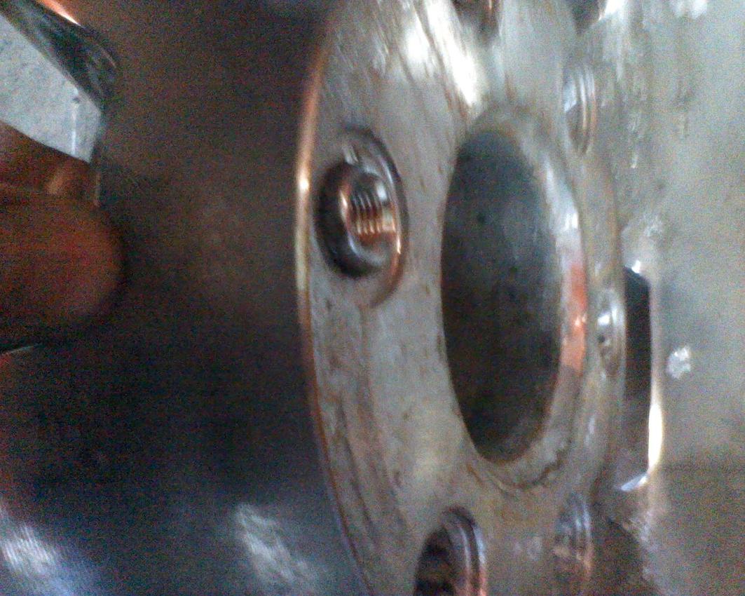

I did get this though, I while back.
customer came in complaining that the vehicle wasn't driving well, swerving all over the road etc..
the lug nuts were at least 1/8" longer than the wheel was thick. they tightened down against the hub, before they ever hit the wheel...
scary...
