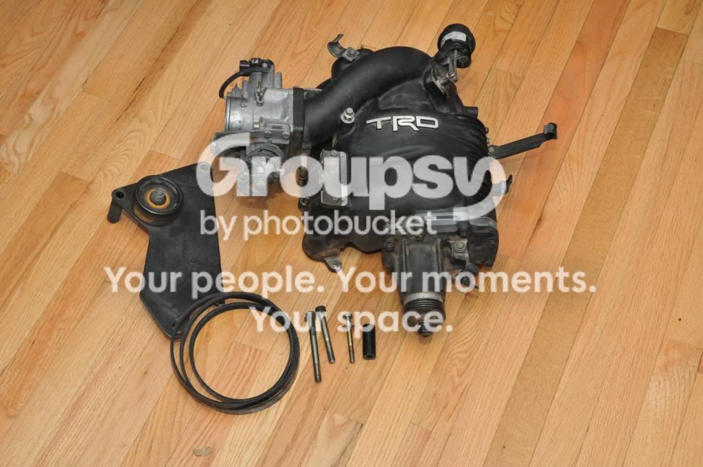

Santa put on a USPS outfit and made an unseasonable stop by my place today! The box it came in was all beat up and had me worried but I think everything made it damage free. Both pulleys spin freely and i can feel suction on the TB when I spin the nose pulley by hand. Time to start ordering other stuff! I'm going to do valve cover gaskets at such during my install so I've gotta collect more than just the SC related parts. I can't wait to get this thing on!
Nice! That is the spacer that goes between the tensioner bracket and the supercharger on the top bolt. Also make sure your tensioner pulley is tightened onto the bracket. Mine wasn't and was rubbing on the bracket when I tightened everything down, so I had to take it all apart again.

You will love the supercharger. I'd replace the nose cone oil while it's off the truck unless it was changed recently. And replace the lower intake manifold gasket when you install it. :cheers:

You selling the supercharger already? TRD supercharger 3 4L V6 5VZ FE | eBay
Shhhhhhhh.... I just ended the auction. I've been back and forth on it all day. I got a little worked up after convincing myself I needed to add the URD 7th and do the trans valve body upgrade immediately. I'm going to put it on stock and see if I have pinging - if so I'm going to try a couple things to reduce the boost until I can afford the URD 7th. If those don't work I'll pull it off and stick it in the closet or back up on ebay. The suspense is obviously taking its toll...
