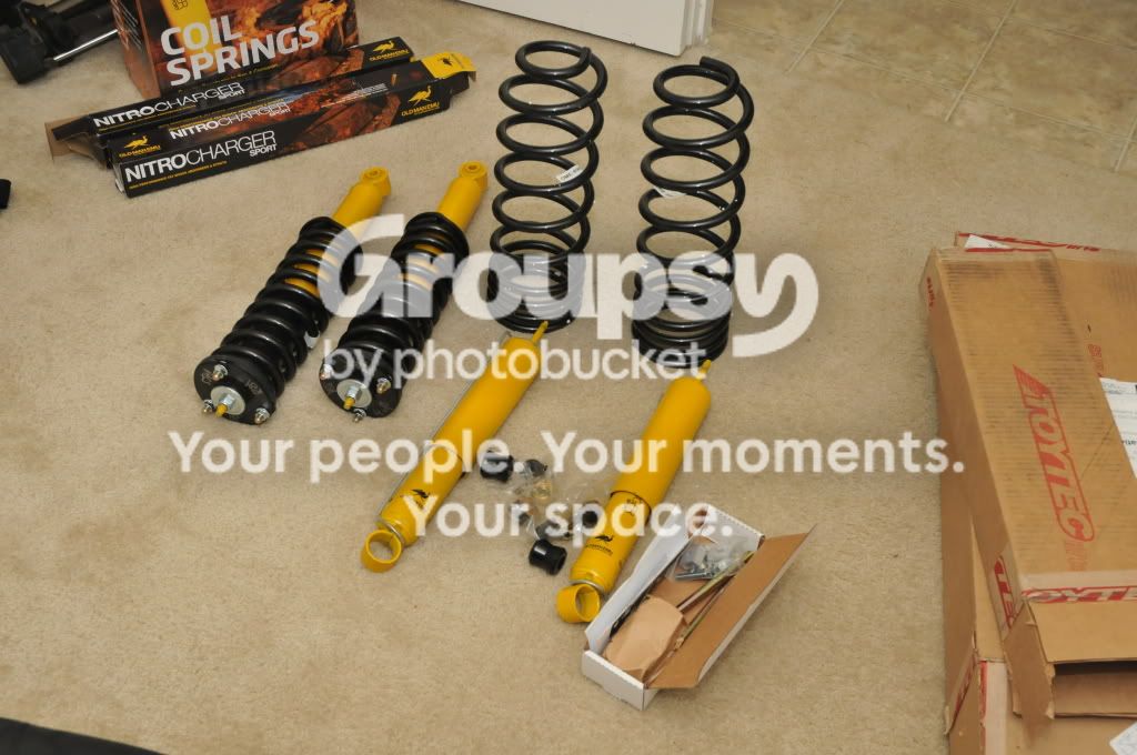

Seems Santa came about a month late today. OME 881/890's + diff drop. No top plate spacer. Needless to say, I can't wait til saturday. Plan is to get the Duratracs installed first thing, then install the lift, then get an alignment. More pics to come this weekend.

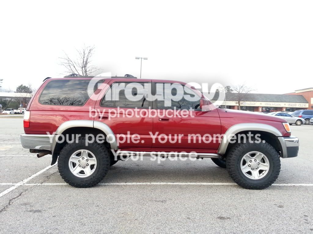

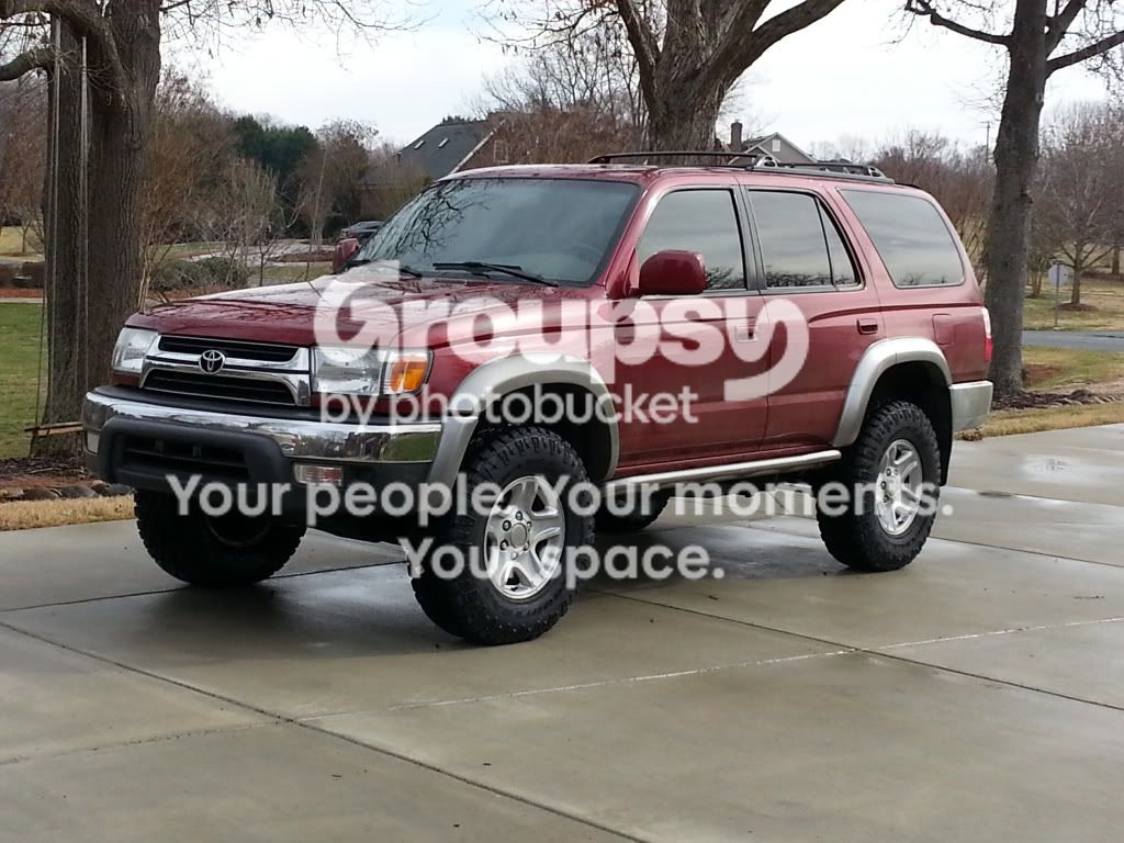

I got the lift and tires on yesterday along with an alignment. I started with all OE suspension parts that had 172k on them and rode rough. The ride with the OME 881/890s is much smoother over bumps and confident in the turns. It also brakes better now that the front end doesn't nose dive every time I touch the brakes.
The install took me, my dad, and a friend about 2.5 hours. We used a sawzall on the rear upper mounts and disconnected the LBJs on the fronts. Those were the only "tricks" we used.
Here's a quick cell phone pic after the install. Scroll up for the "before" version.

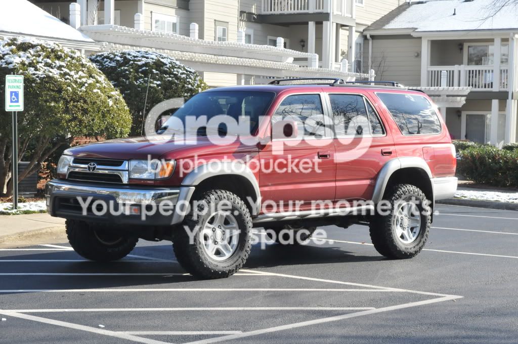

Hey, BenK...does your truck sit level with that lift set up? It looks pretty level from the picture, but can't quite tell. I'm looking to do the same lift as you and I want my truck to sit level. Also, did you add the top plate spacer for the front?
Diggin' the silver sliders, matches well. Normally not a fan of the Red Runners, but this looks like the start of a beautiful set up!
Kanger- Here's a better picture now that the lift has had a chance to settle in. I did not add the top plate spacer. This gave me about 2.5" up front and 3" in the rear. I like the look of the rake and wanted to be sure I wouldn't have a reverse rake if I loaded up the back.

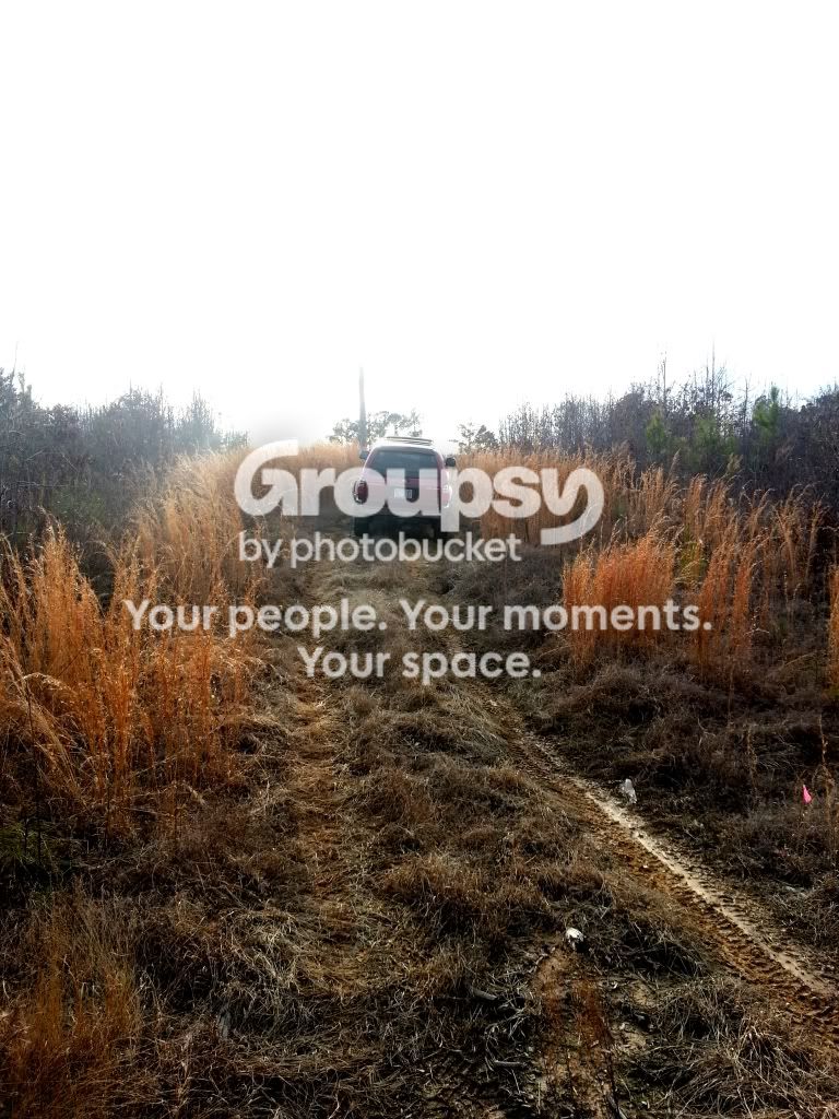

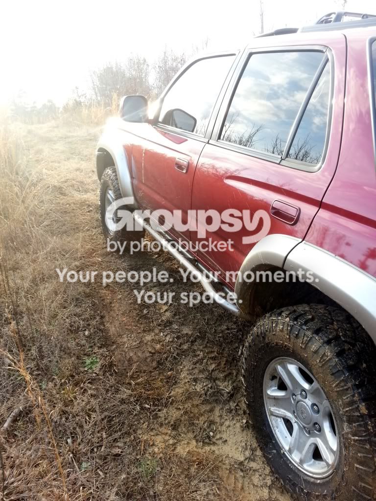

Finally some wheelin'
I finally got a chance to do a little wheelin' today. Here's a few pics-

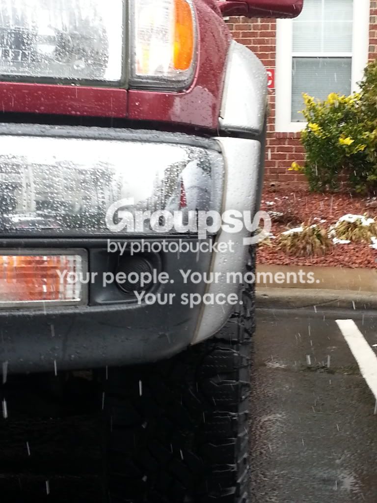

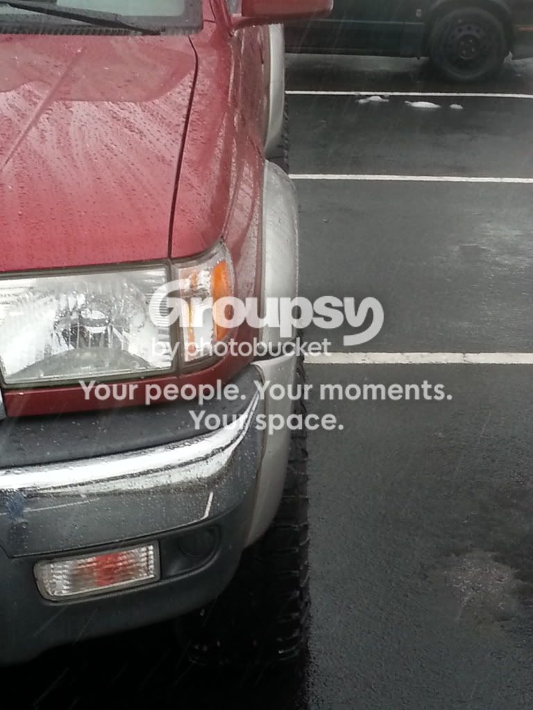

Just my luck, it started snowing yesterday just before Fedex dropped off the wheel spacers and body lift. Not the end of the world though, I went ahead and installed the wheel spacers then put the body lift on today. Couldn't be happier with the results.

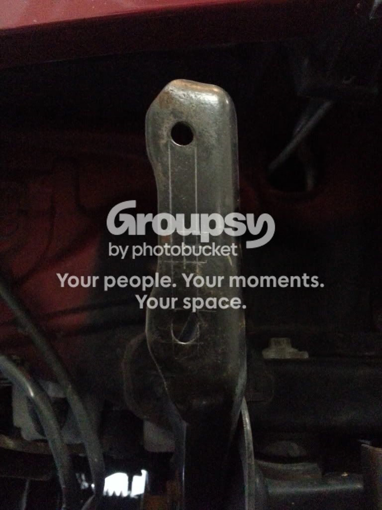

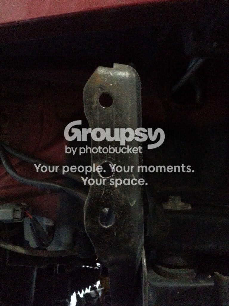

Working by myself in the cold today, it took me about 6.5 hours to install the body lift. I didn't order relocation brackets for the front bumper. Here's how I modified the brackets to raise it up. I raised the lower hole and made a small notch in the top so that the upper stud would clear the bracket without bending it. I wasn't worried so much about keeping the mod reversible, but I figure I'll want to sell the bumper someday, so might as well keep it stock.
Here's some before and after pics-
Before WS:
20130216_153342_zps361c21a2.jpg~original
After:
20130216_172015_zps9eb333d5.jpg~original
