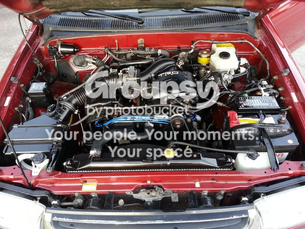

I got the supercharger installed on 3/10. Everything went smooth as could be. I also changed to a 170 degree thermostat (Stant 14077), Denso IK22 plugs at 0.043" and changed the belts. Overall I'd say the TRD instructions were adequate with a little forum help needed here or there. Big thanks to [MENTION=53337]SCRunner12[/MENTION] and [MENTION=76627]nor_cal51501[/MENTION] especially.
I fabbed a makeshift dipstick relocation bracket out of some aluminum but its not very strong so I'm going to replace it. For the wire loom bracket, I cut the beveled edge off, flipped the bracket over and then just zip tied the wire loom to the back. Both were simple fixes that were obvious once I got started. It took me about 6 hours of work across 3 sessions and included the tstat, plugs and attempting to replace my fuel filter (one end still frozen). All of this was done in the parking lot at my condo with simple tools - no one should be afraid of doing this install on their own. I didn't take a lot of pictures or feel the need to do much of a write up since this install is so well documented. I'm glad to try and help anyone out that needs a hand though.
It fired right up when I got done with zero pinging so far running 93 octane. I don't plan on getting a smaller pulley at this point. I may get the URD 7th for peace of mind though - maybe even the transmission valve body upgrade. I don't plan on driving this thing like a racecar though so I feel fine with how it is for now. Ever since the lift and tires went on its felt a little under-powered in certain situations. The supercharger gives it a much needed extra bit of oomph. I notice it most on hills where the AT used to downshift - it just holds the gear and accelerates easily right up those hills now.
I love this thing. I missed my SC'd Tacoma for way too long. Ironically I was hesitant about putting the supercharger on that when it was 6 years old with 70k and a MT. I have over 2.5 times the miles on my 13 year old AT 4Runner and it still runs like a top! Not for everyone, but definitely for me! :cheers:

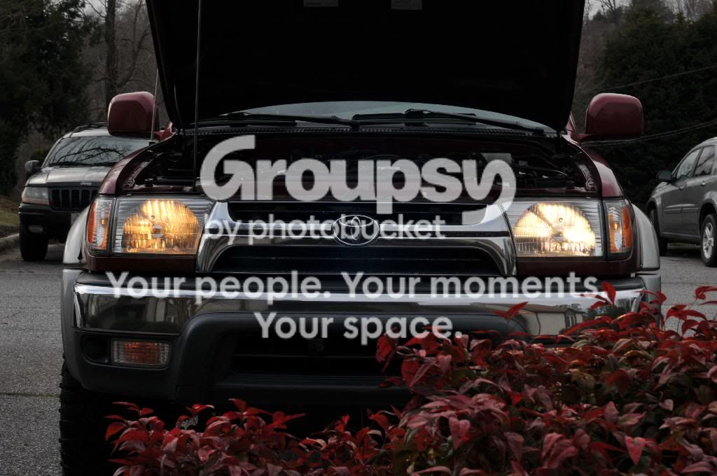

Got a pair of Sylvnia Silverstar Ultras off amazon for $27. I always feel like I need my brights on and thought it might be the bulbs. Well I can definitely say these make a huge difference.
Another thing I thought is I never aimed my headlights after the lift, which is higher in the back. I'm guessing that needs addressed too but for now I couldn't be happier with the new bulbs.
FYI I have the DRLs disabled so hopefully these last longer than some of the reports I've read here.
1 year old stock bulb on the left, Silverstar Ultra on the right.

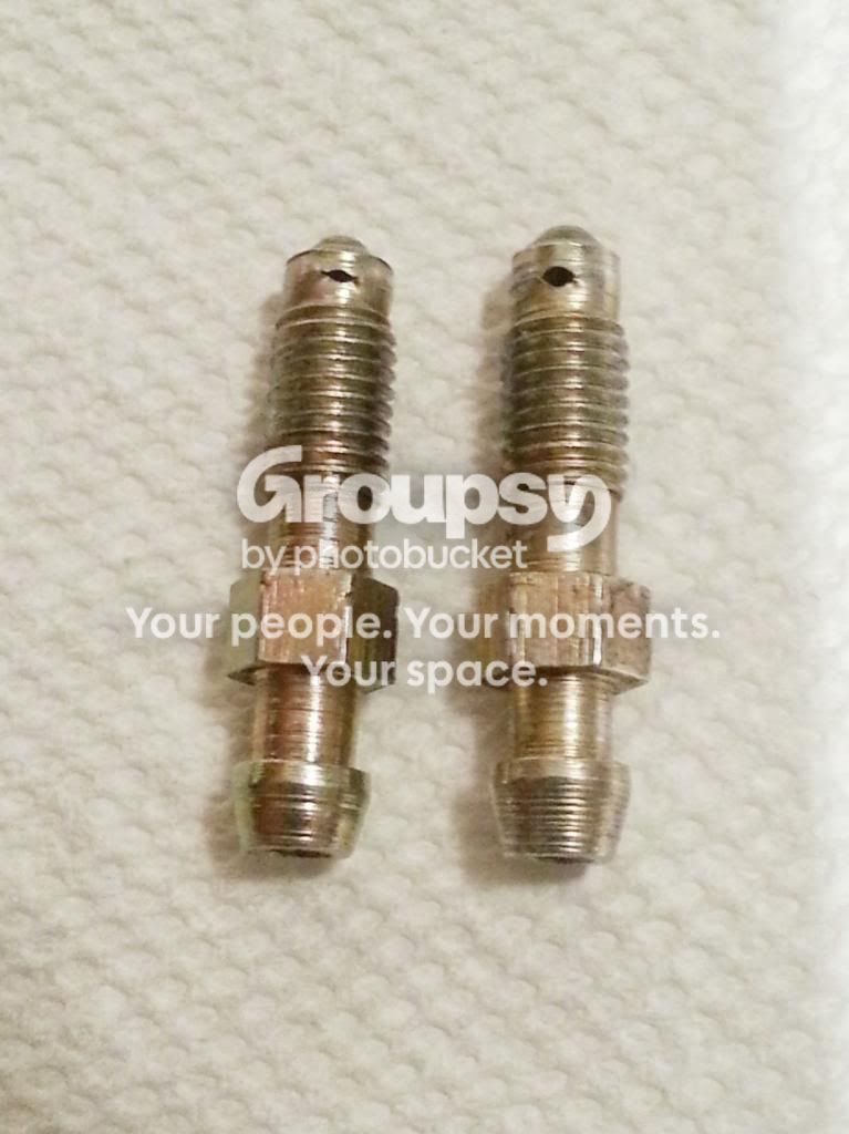

The only thing I'll comment on is the bleeder screws that came installed in my Napa reman'd calipers. First off, I'd already picked up some speed bleeders (which I'd highly recommend) so this didn't really effect me. However, when I pulled the bleeder screws out for the swap, I found that they'd both been way over tightened and the ends of each were mushroomed and the hole was collapsed. Pretty disappointing, but no big deal for me since I was replacing them anyways.
bleeders_zpscdbd1019.jpg~original
The speed bleeders made these extremely easy to do a one man bleed job on. I then did the bed in procedure and man alive! What a difference. I can't believe I waited those other pads out to do this mod.

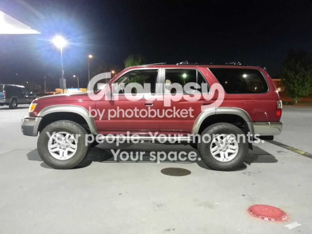

17" Tundra Wheels
I finally found a deal on a set of 17" Tundra wheels. They came with 295/70/17 Terra Grapplers. I'll see tomorrow if they fit. Between my lift, body lift and wheel spacers im hoping I can run them for a while and save up for something else. More tomorrow...
20140504_205212_zpsjz2fg0hm.jpg~original
20140504_205626_zpsswz7merb.jpg~original
Tundra 17s Installed
I got the Tundra wheels installed last night. The 295s fit with some trimming. I didnt mind trimming since I plan to get 285/70/17s when these wear out. I like the fuller wheel well look but the Terra Grapplers dont look as good as the DuraTracs by a long shot.
