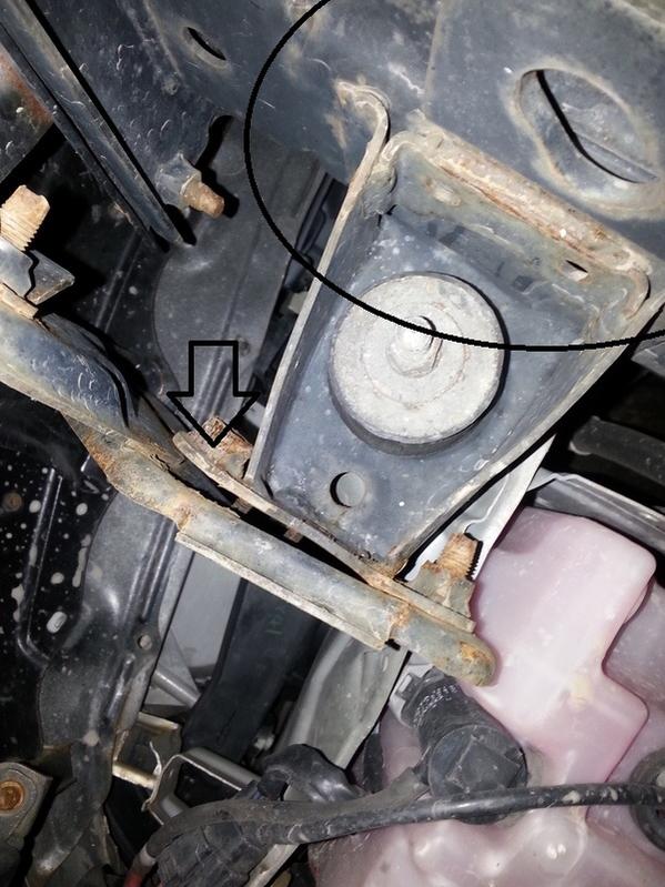

I found one area that was bent, the body mount that the bumper connects to on the passenger side. I wonder if this is enough to skew up all the body lines? I won't know until I measure some more

The missing bolt (shown with the arrow) is what caused the bumper to be high on the pass. side. You can level the front bumper with a bolt in. Loosen all 4 bolts onn both sides and level it and then tight all 4 bolts.
Post more pictures near the circled area. From the picture I see nothing major to the frame.

Thanks for the help! I will grab more pictures of that area soon. I will admit, I didn't see any wrinkles or noticeable damage while under there, besides the bumper mount.
