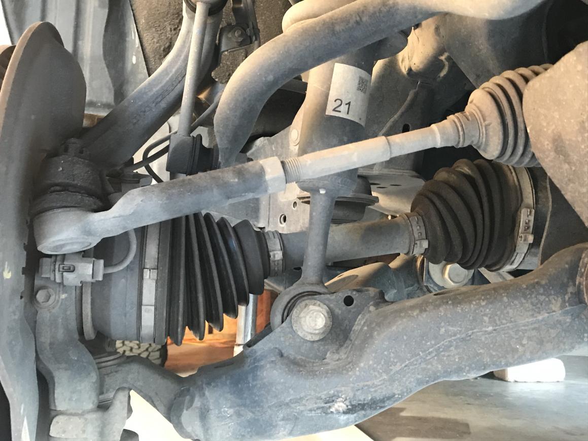

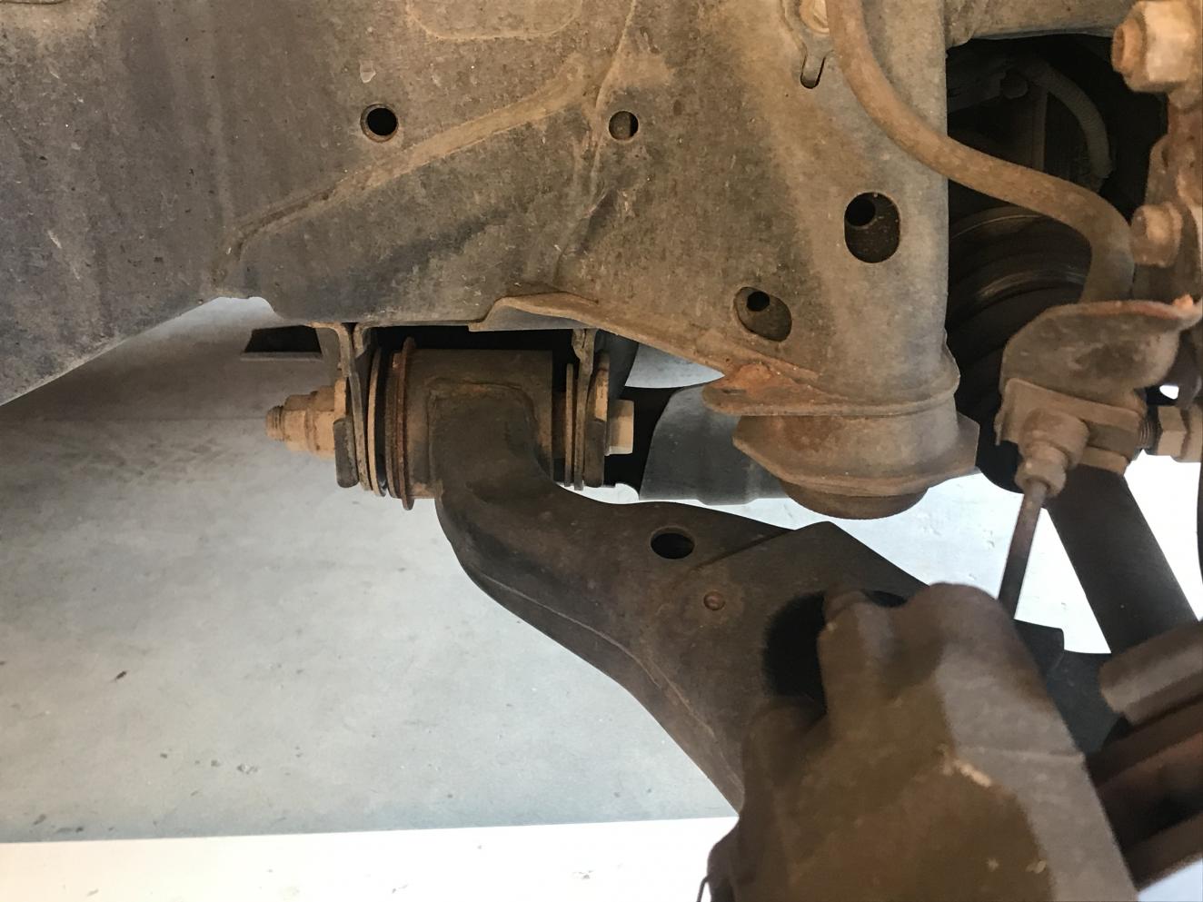

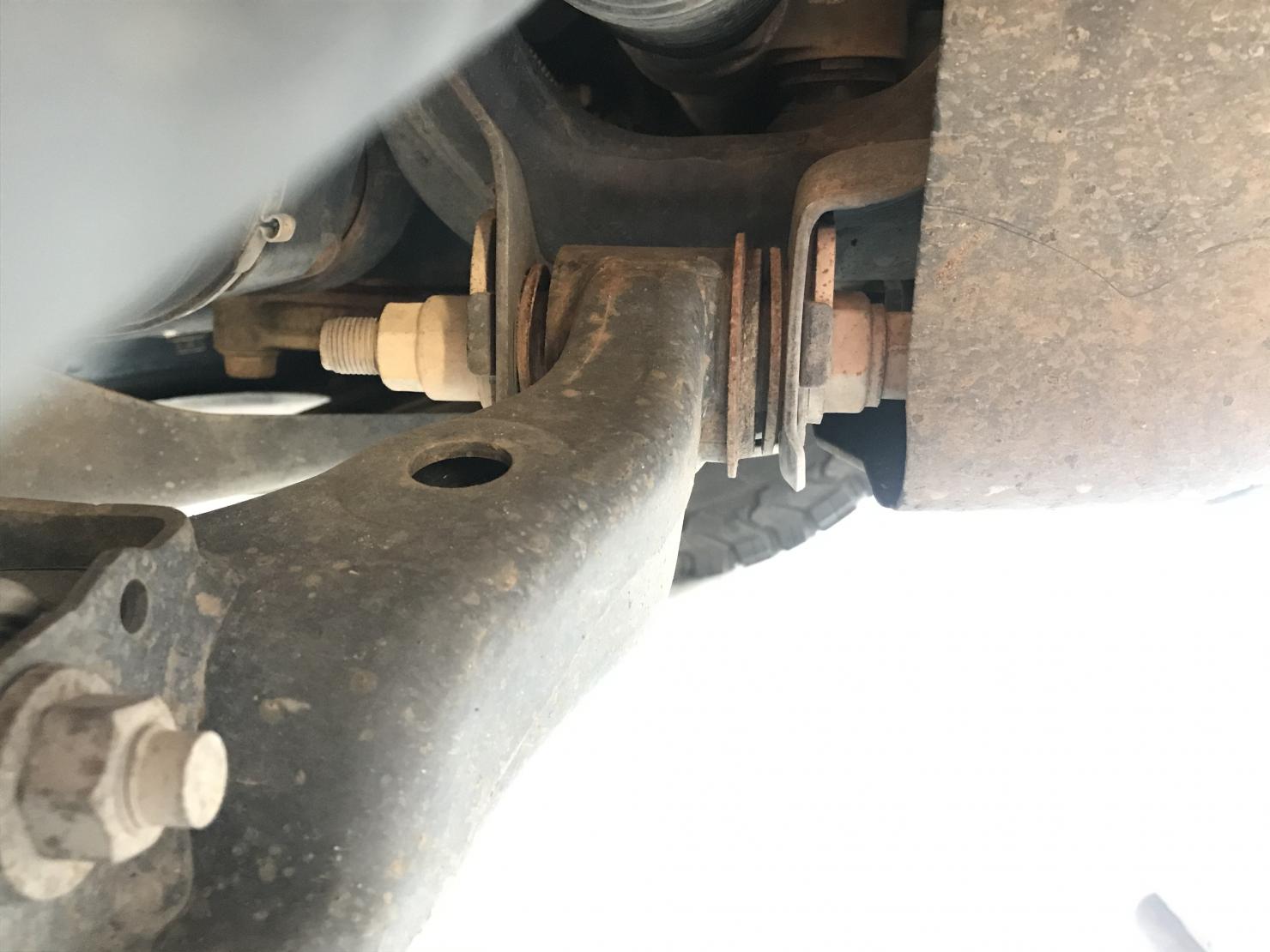

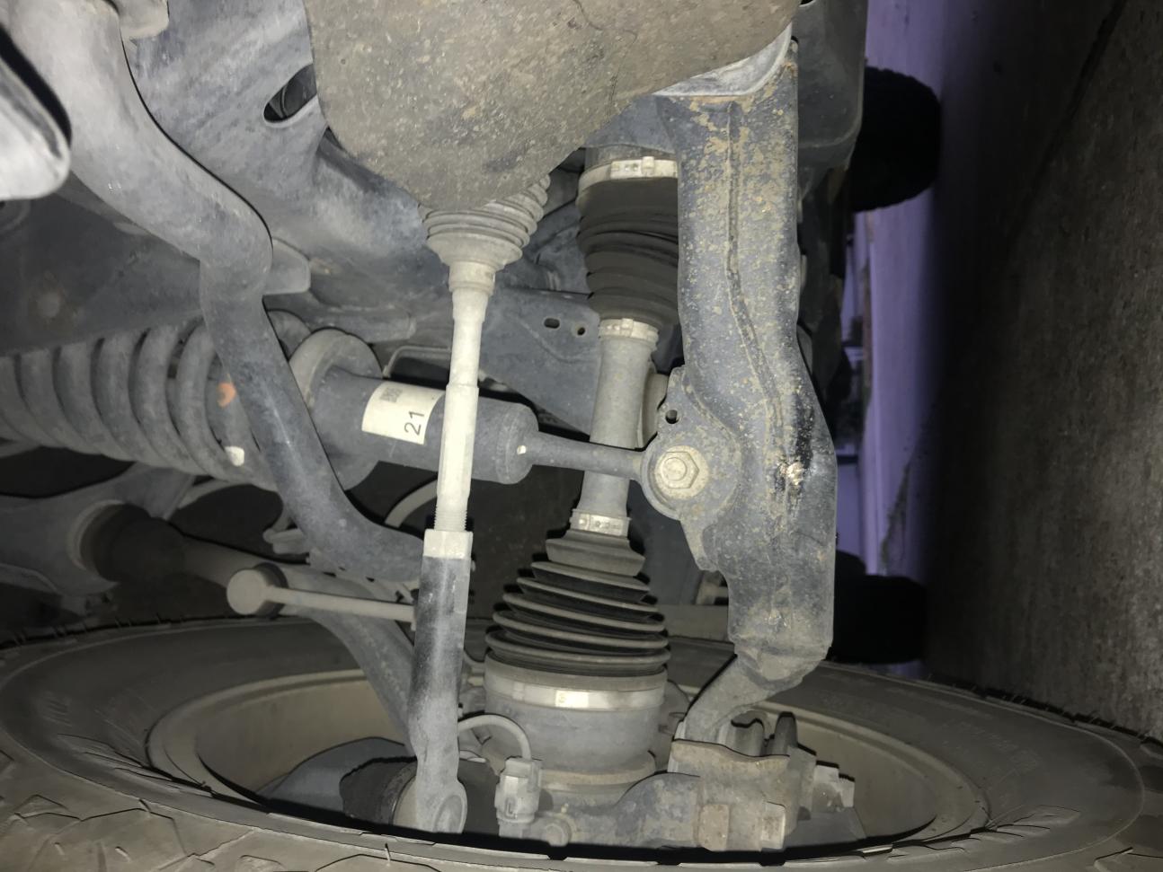

Finally got back in town and had some time to look at it. I took the tire off and inspected everything, and honestly, nothing looked out of place/bent to me. Threw the tire back on and took it to Pep Boys for an alignment. I didnt tell them why it was out of alignment, I wanted to see if they would have any trouble with it. They got it aligned with no issues and everything seams to be good as new. Pretty sure Im done going to the old shop that wanted $1400 to replace the LCA and spindle.
Here are some pics. 1st pic is how far out of line the steering wheel was driving strait down the street. You can see the scuff on the LCA where it landed on the concrete right under the shock mount.
