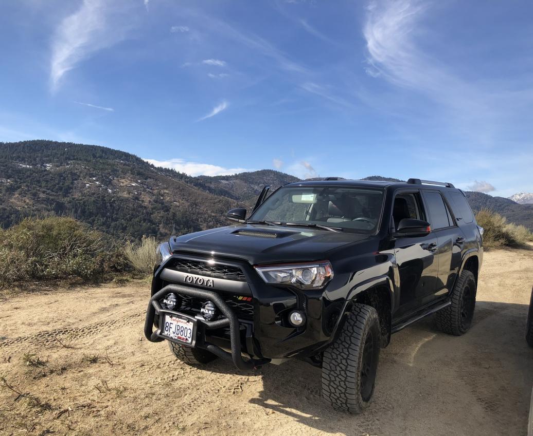

I did the Burtman Industries 1.5/1” UHMW Cornfed spacer lift on my Pro. I started with 275’s, but I am now running 285’s. Inexpensive and they have worked great on and off road for two years now.
