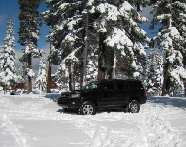

The snow stopped and we decided to go for a nice fall walk. The destinations felt very good; there was plenty of bite and control. If i didnt have studds, id definitely run these tires this winter.
