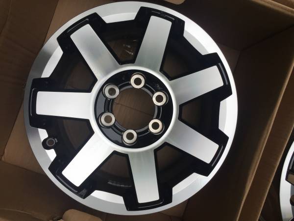

TRD Off-Road rims. For the most part, it will be street driven. He may eventually get interested in some lite off-road. I appreciate the help.

Yep, those are nice rims. I run those exact same rims for my winter set with 265/70R17 Toyo Observe GSi-5 tires on my 2011 Limited. I then switch back to the 20 inch Limited rims for the summer.

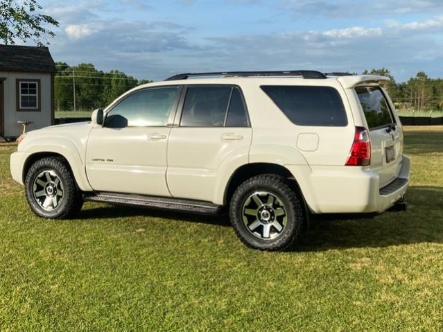

Finally got the wheels installed. Stuck with the stock 4-gen tire size for the time being. Goodyear Wrangler Duratrac tires. Now looking to do a minimal lift.
Honestly, you should have went with the 70 series since you’re now thinking of doing a minimal lift...
