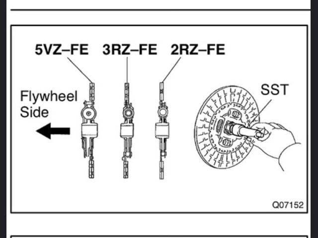

[MENTION=116470]Tyler James Inc[/MENTION] yeah I don't know what happened. Got it from RockAuto and it was a disaster. Clutch wouldn't disengage. (Pressure plate fingers must have been pushing onto clutch disk before disengagement) Had to pull transmission and reinstall the old clutch and send it back due to lack of time. Couldn't risk flipping disk around and maybe have to remove transmission for a 3rd time that day. When I attempt to tackle it again, I'll just go straight to Toyota for pressure plate and flywheel.
At any rate, there is a thread or image from FSM somewhere that says the 3.4 is the odd duck with a clutch disk facing opposite of just about all others. Too little too late for me now, but might help somebody
Edit: found picture
