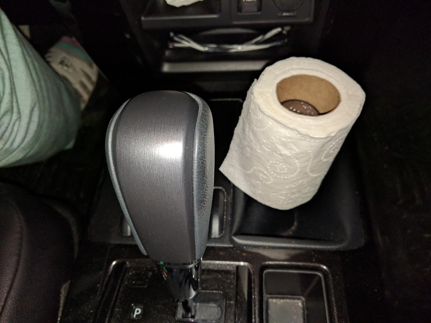

I finally found a use for this extra knob sticking up from the console.

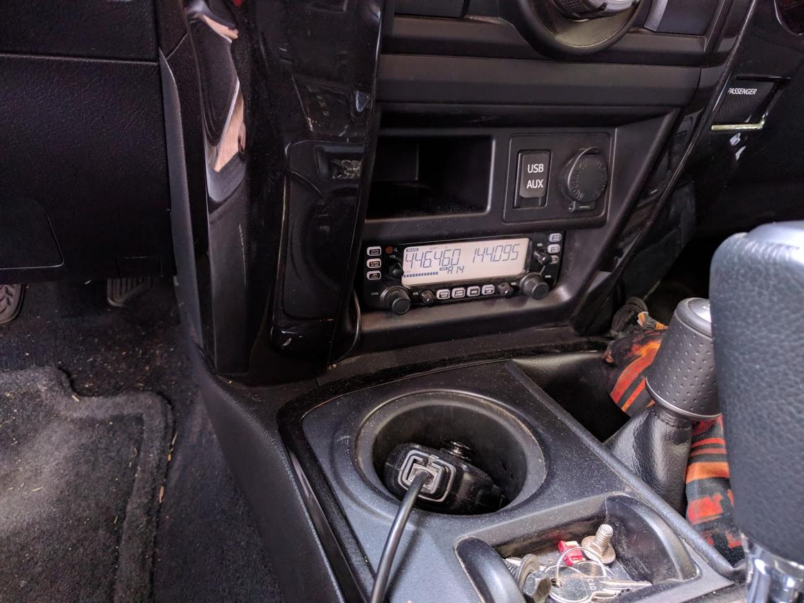

i have an Icon IC-2730 (incidentally used to be Meefzah's), and the faceplate fits perfectly with just a press-fit into that opening and stays put. It doesn't sound super robust, but it never moves unless I want it to. It also blends in really well with the rest of the dash. No trimming needed unless you really want to hide the faceplate cable (you can see it in the photo)
From my driver seat, the only thing I can't see easily is which channel is active, but it's rarely a problem (I've only accidentally spammed the WIN system with casual simplex banter once...). I overall love the radio if you just need a solid dual bander for comms and not all of the extra bits and bobs coming on flaghsip mobile rigs.

Thanks for the picture! The IC-2730 is the radio I just bought and I'm really happy to see the faceplate fits perfectly in that spot. Trying to do the least invasive install I can with it being a new rig.

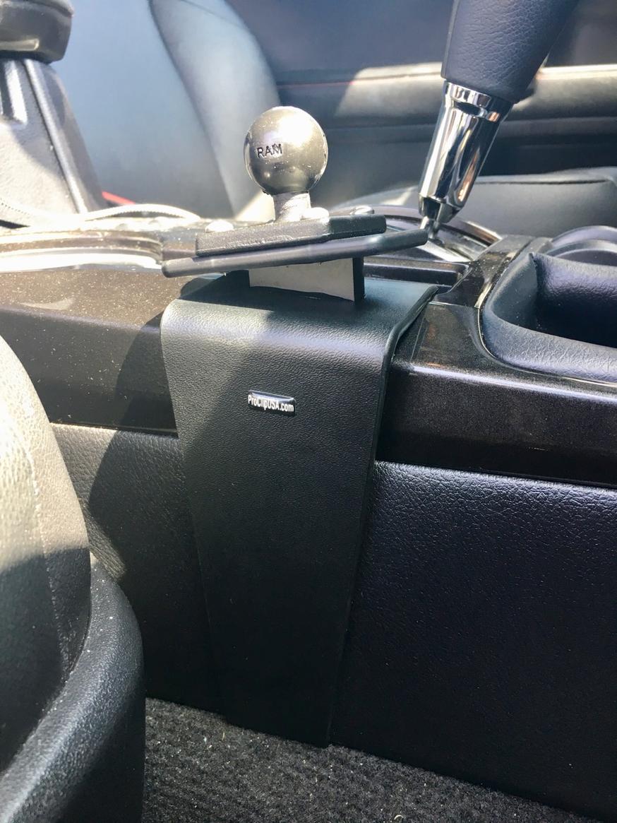

Another question for the experts out there. Were there any changes to the center console for 2017 besides the carbon fiber look on the TRDs?
I'm looking into buying a Proclip mount 834492 and their website only lists it for '10-'16. Talked to someone from Proclip today to see if that was true. He said it wasn't listed on the site because Toyota changed the console. I'm skeptical of that based on pictures I've seen of a '16 and a '17. Anyone think that might be true?

Guys, this model looks to be all the radio I need...for now. Ha!
Questions for you though:
I looked up the model: IC-2730 and Icom kept bringing up a model with an "a" at the end. Is this an update to your models or are you just "short-handing" the model you have now?
I am seeing pictures of the mic plugged into the faceplate and the radio unit's "brains". Are both an option or just one?
Last, [MENTION=143747]Bryguy17[/MENTION], how is the radio visibility with a water bottle or cup in the front cup holder?

Looking over the website, the "A" designates the model version, and it is the latest version (old one was an IC-2730H it seems). Mine is an IC-2730A.
The radio consists of the faceplate, a radio box, and a handset, all connected by either a cat6 or RJ45 cable. The handset can be remoted from either the base or the faceplate, depending on which fits your installation better. The radio box on mine is under the driver seat, velcro'd to the carpet on in front of the rear A/C vent, so the mic still reaches fine to myself or the passenger without having to come out of the faceplate (which is an awkward plug location IMO). I definitely recommend a new speaker as well. I put an MFJ cleartone right next to it and it's a night and day difference vs. the built in speaker.
I rarely have a drink in that cupholder (on account of it being used as a mic holder), but I imagine at least the left portion would be blocked depending on the size of beverage. There is not much getting around that, though, unless you mount it somewhere much more accessible (on a ram mount, etc.)
i can still get to my radio with a drink in the cupholder, it just makes it a little tougher
i set the function keys on the mic to do what i need, so i generally don't need to actually mess with the radio though
