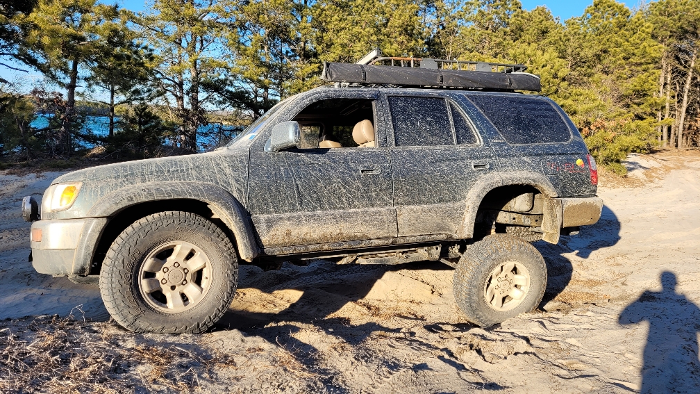

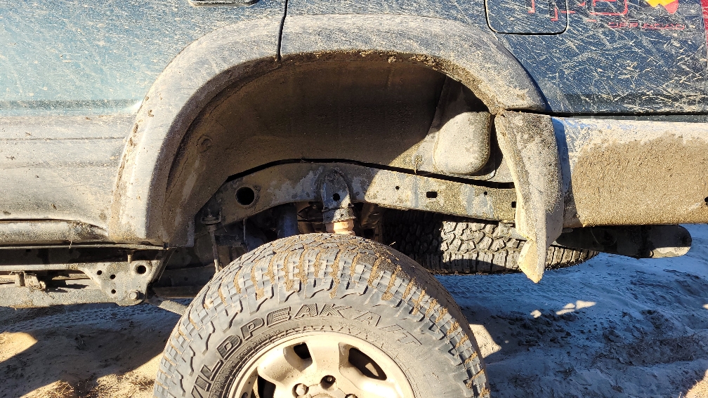

Below is a photo of full flex/lifting a wheel with the LC shocks in.

I'm running 1995 4runner links which are ~2 inches longer than stock and the 890s are firmly in place. I grabbed onto the 890s at full flex and could literally shake the whole truck back and forth when yanking on them. Solidly in place. I do have the top cone bumpstops in there though. I'm sure this adds another inch or so to their length
That looks pretty good, have you measured your flex and compression to see how much travel you're getting? Like wheel travel.
