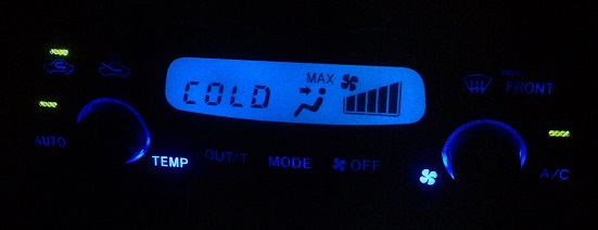

I used the 3X 5630 Samsung for $5.99 ea. The ones right above on the web page weren't there when I made my purchase but they look like they might be even brighter and they're $1 cheaper. Go figure. If you're going with one of the colors I might be tempted to get the brightest LEDs possible. The wax paper is a great idea too. The Limited AC control uses a piece of thick wax paper to evenly spread the light behind the LCD.

Since you have an SR5, you need mostly #74s. I would probably buy MOST of my LEDs from www.superbrightleds.com They are the cheapest and I haven't had any problems with the #74 size bulbs. However, their T3 size NEO wedge LEDs (the one for the ECT, RR defrost and window switch)the base is loose in the hole it wedges into. For these I suggest getting a set of your preferred color from VLEDS They fit much better, almost too tight but you can pop them in and if you need to turn them 180 you can reposition them.
I had the blue in my 2000, same exterior color as yours. I put white in my 99. Just did the blue LEDs in someone's control and I'm seriously thinking about going back to it. Still don't like the colored gauge cluster however.
My head unit is blue and I think it would look much better matching
Yes, that's usually the main factor in the color decision. Of course some of these HUs can display a variety of different colors. Don't forget the buttons above your Digital Climate Control.
