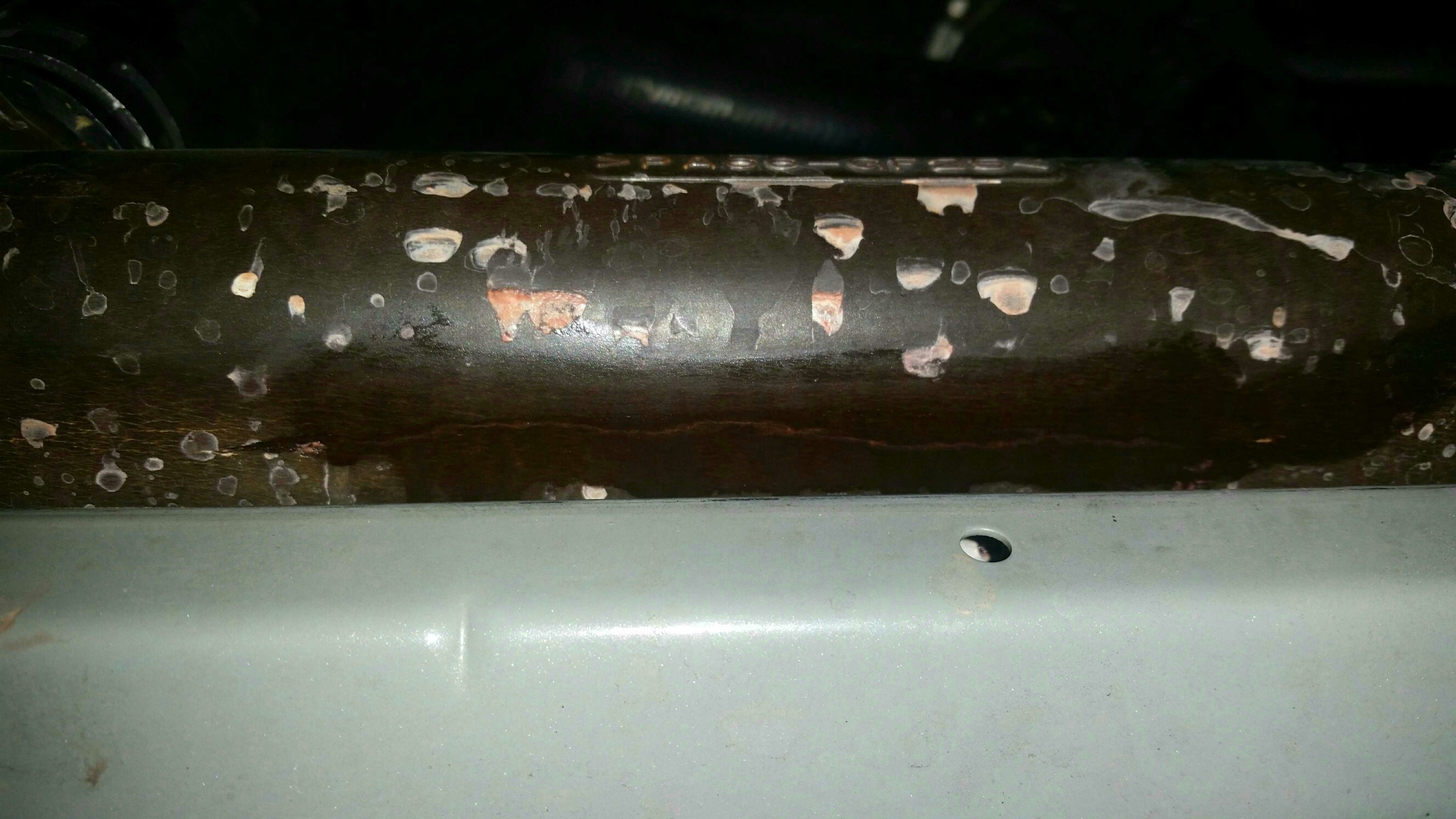

So I came out and opened the hood of the rig after smelling some coolant and saw the top of the radiator tank had cracked. Bad thing is it's close to the holidays and getting one shipped isn't going to happen as soon as I need it. So besides the stealership, are there any parts store that carry a comparable radiator? Or am I stuck til next Tuesday? That's the soonest one will get here without paying ridiculous costs for 2 day or overnight shipping. Here's a pic of the damage
I was able to find a denso locally for 137 at parts authority. I'll probably grab that. Looks like the radiator cap failed also. Am I good to go aftermarket on that or do I need factory? And obviously go factory on the thermostat yes?

I thought of doing this but I'm looking at 215 for the radiator this way. I can get all of the parts oem excluding the radiator and spend that amount on the whole job. Denso radiator I heard is good quality. So I am going to try that. We are taking the 4runner to family Thanksgivings tomorrow. Easier to travel around town in then the Subaru. A little more roomy. Thank you though. That was my first choice
I purchased a Denso for my '99 from amazon for around $100 looked about 90% like OEM. However, I purchased one from Carquest for my '97 for around $115 that looked more like 98% OEM. Both have been great!
The OEM radiator would be optimum but in reality the Denso will more than likely outlive the life of your 4runner.

I was able to get all the parts and get it done today! Thank you everyone for your help! The denso radiator looked exactly like oem. And seems pretty solid! Hoping it lasts as long as oem!
