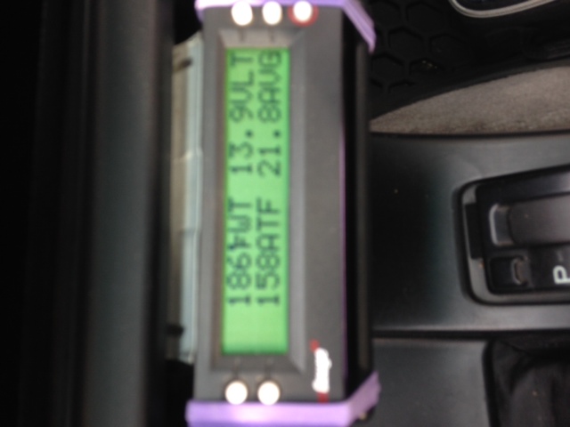

Best mileage I've ever gotten from her since I bought her in 08.
I just had a check valve replaced by the dealership so that I can pass emissions this month to get new tags.
Please excuse my ghetto scanguage mount...the purple rubber-bands were all we had at work...:peep:
Can't wait to see what some new plugs and cleaning the MAF will do.
I'm a little excited, I've been getting 16 to 17 on average for 6 years...
Sorry for the blur, it comes standard with every iPhone.
And my picture is the correct orientation on my computer...WTF?

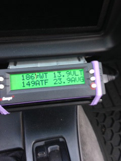

NOOOOOOO! It's not any kind of wearable part. I had a leak in my evap system, which was keeping the fuel system from pressurizing. I've been chasing the 440, 446 and 442 codes for years. I replaced the charcoal canister about 2 or 3 years ago, then the VSV valve and it still threw codes. Had the dealership diagnose it since I wasn't getting anywhere and they found the leak in the check valve (they called it the ORV valve) $590 later (labor for dropping the tank) I passed emissions yesterday and reported this on the drive home from the emissions station:
