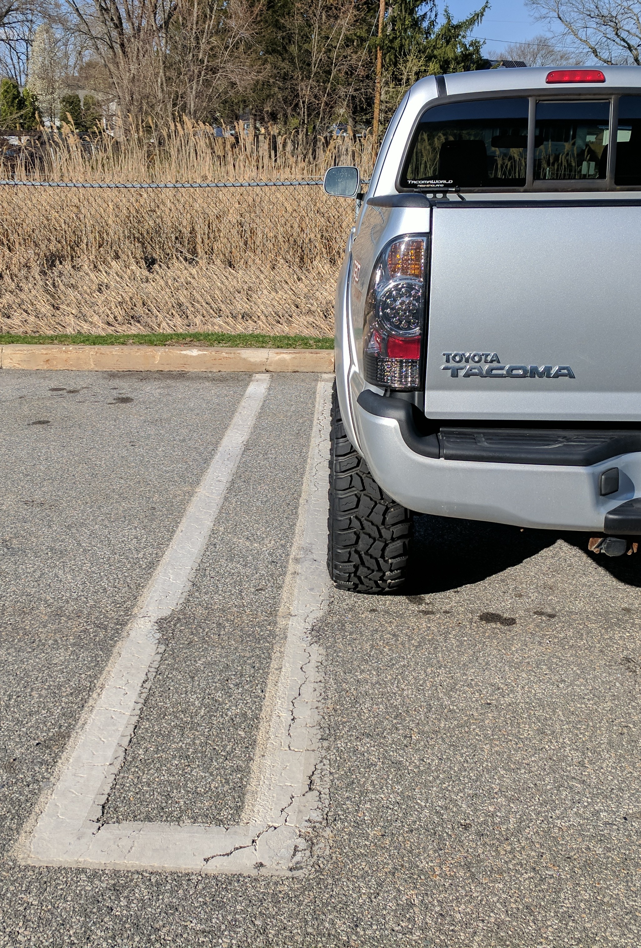

On my 2nd gen Taco, I had +10 offset wheels with 285/75R16 tires. I like the look of the tires being flush with the fenders. A 0 offset with the same tires were close and still looked good.

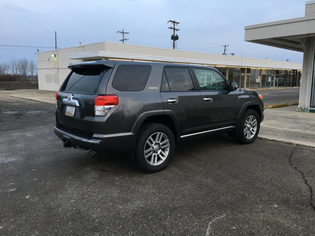

Not sure about offset and all that.., I’ve got the stock limited 20x7’s,
285/55-20’s with 19mm spacers... seems about perfect to me.

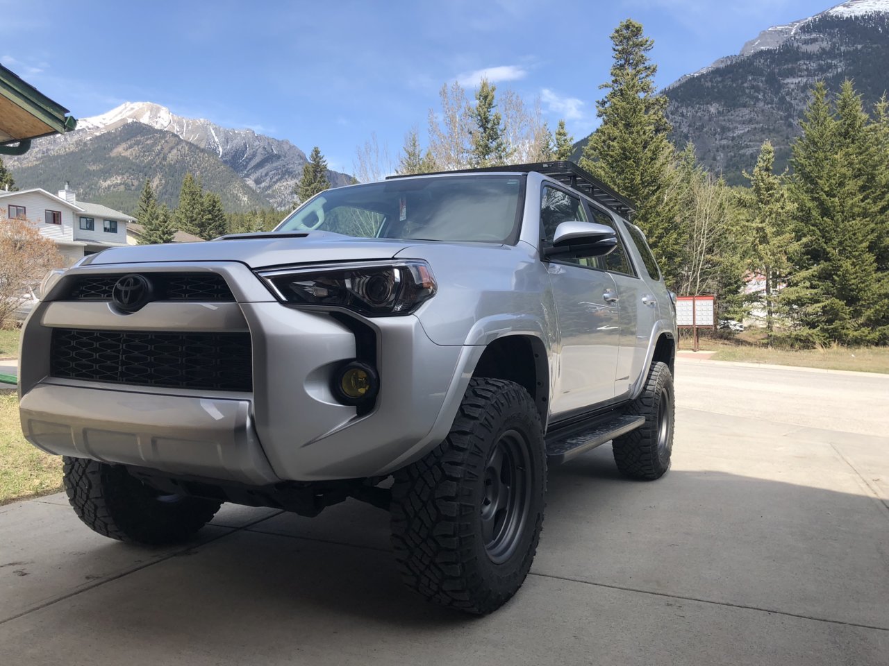

-10mm offset and 4.30" bs on 285/70/17

The pictures make 0 and -10 look about the same. On my Tacoma, the sidewall was even with the top of the fender flare.
