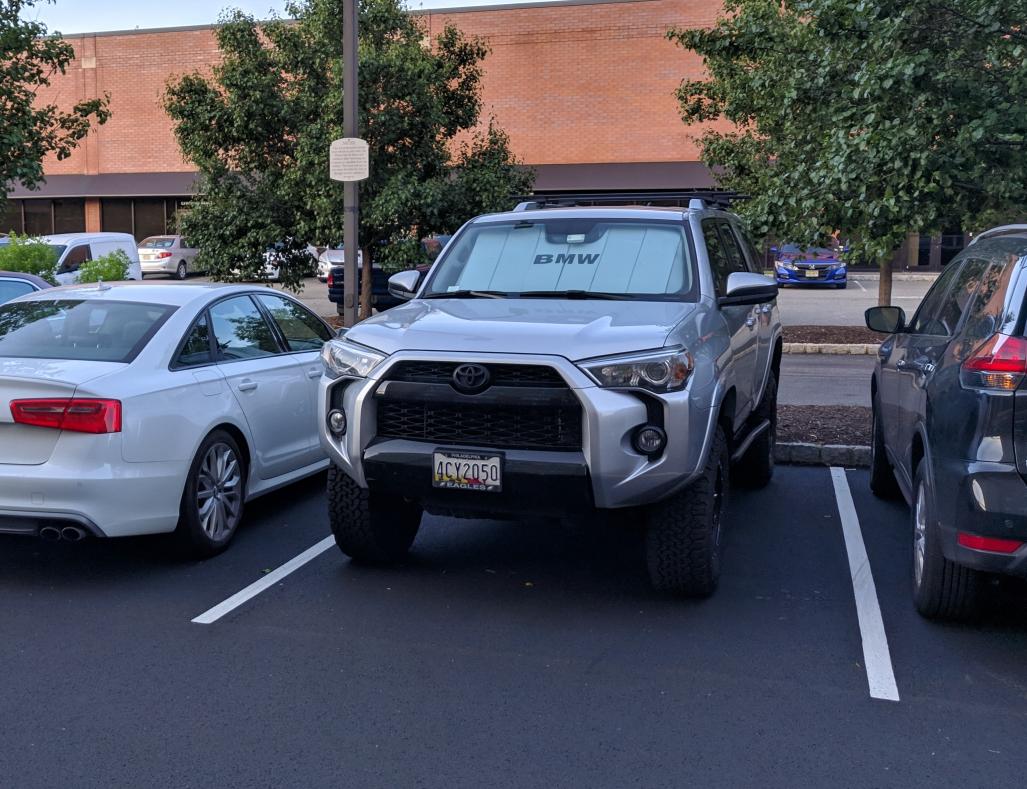

So I spotted this in NJ today. Has 285s with what appears to be 17x9 +1 wheels. I think a -6 offset is what I'm looking for.

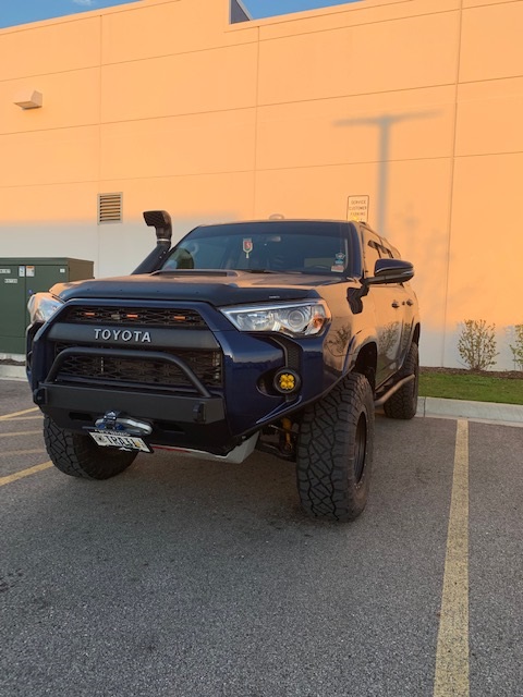

SCS RAY 10 17X8.5 -10 OFFSET with a 285/70/17 ridge grappler. Sits pretty good
