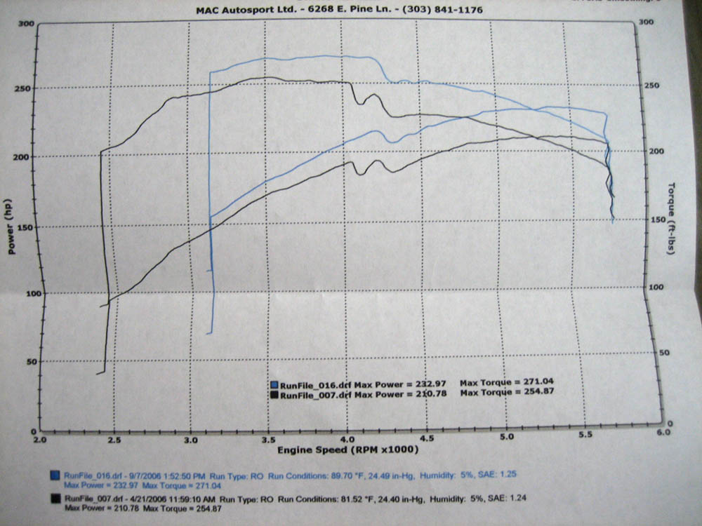

I'll agree its mostly pointless/expensive to try and get more hp out of our trucks but...
Dyno graphs?
I'll summarize:
+23hp and +16tq when adding an intake and a tune to the vvti V8 that already has a magnaflow catback system. This gain is throughout the powerband.
Adding headers (proven 12hp untuned gain) + performance cats + deleting the rear cats + installing a decent y pipe (factory one is crap) should gain 30hp more.
Thats +50hp over stock for $2500. Half the price of supercharging for half the hp gain.

The graph in the post you linked is a broken link because I would love to believe there is no low gain loss with bolt ons.

OK, now for the results of the Split Sec PSC1-001 performance control module. We threw it on and put it on the dyno and realized anywhere from 5-10 AWHP, with alot of the runs being around 8 AWHP. We tuned from 11.8:1 AFR and leaned up to about 12.9-13:1. At one point we were around 14:1 and the power was down a bit and the torque was up alot, as much as 270 ft-lbs when it was that lean. As far as what I got, I'd say its about 8 AWHP, which is exactly what I expected. The dyno sheet says about 5 AWHP over the intake, but that was after about 10 dyno pulls in a row, it was starting to get pretty hot in there, and the cooling fan was engaged too. So anywhere from 5-8 AWHP.
Comparison - Just exhaust vs. Intake/Exhaust/Tune:
You wanted a dyno graph, here it is, 3rd page of my link. As indisputable as it gets.
