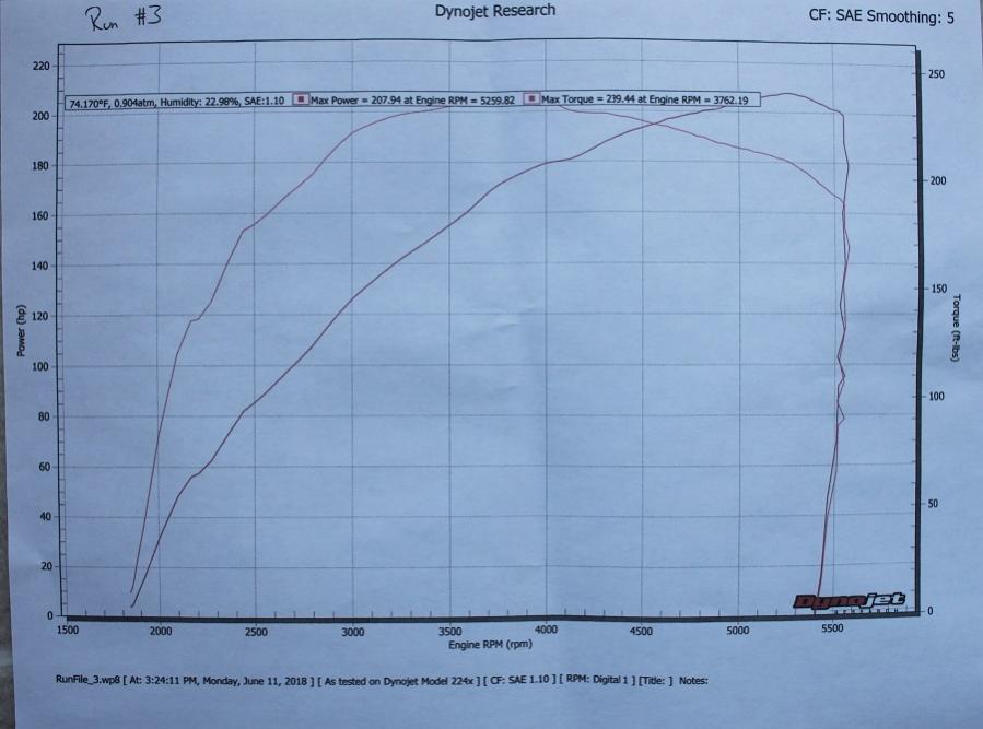

So... mine ended up at 208 HP and 240 Torq.
Also added a intake manifold plate.
Average 15.3 mpg.
