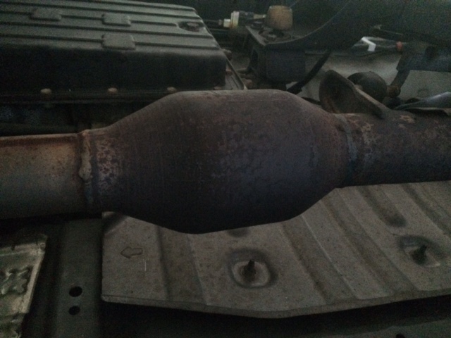

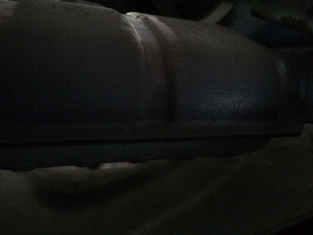

I hate to bring up this post, but started to order my two CATs when I took a look under the truck and don't think I have two. I've included some pics of what maybe a CAT, then a pic of what I know is a CAT, then a pic of my emissions sticker under the hood.
Can someone tell me how many CATs I have and if I have a Cali truck or not?
