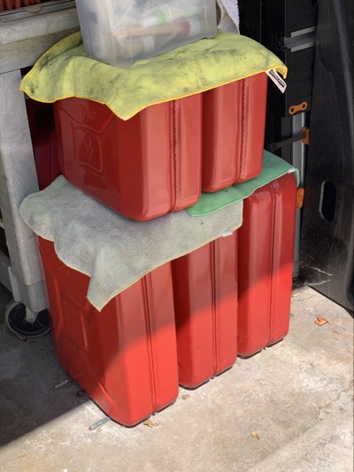

Several years later, after a sizable earthquake and a days-long power outage, I decided I needed more fuel storage capacity, so I bit the bullet and sprung for another pair of jerrycans. By this time only re-enactors we’re shelling out the huge prices for original Wehrmacht cans. So I bought “re-pops” from Wedco. Wedco was only an importer, and the cans were made in Latvia by a manufacturer called Valpro which took over manufacture of the cans after the war. The Valpro cans are a faithful, if not exact reproduction. The Wavian cans available today are made in the same facility as the Wedco cans were, and are identical in every respect except for a brand stamping on the side. The Wavian/Wedco/Valpro cans use a lighter gauge sheet metal than the original German version. In spite of that difference they still meet the NATO specification. I have 10 cans now (some are 10 liter and some are 5 liter). They have been continuously stored full for years.

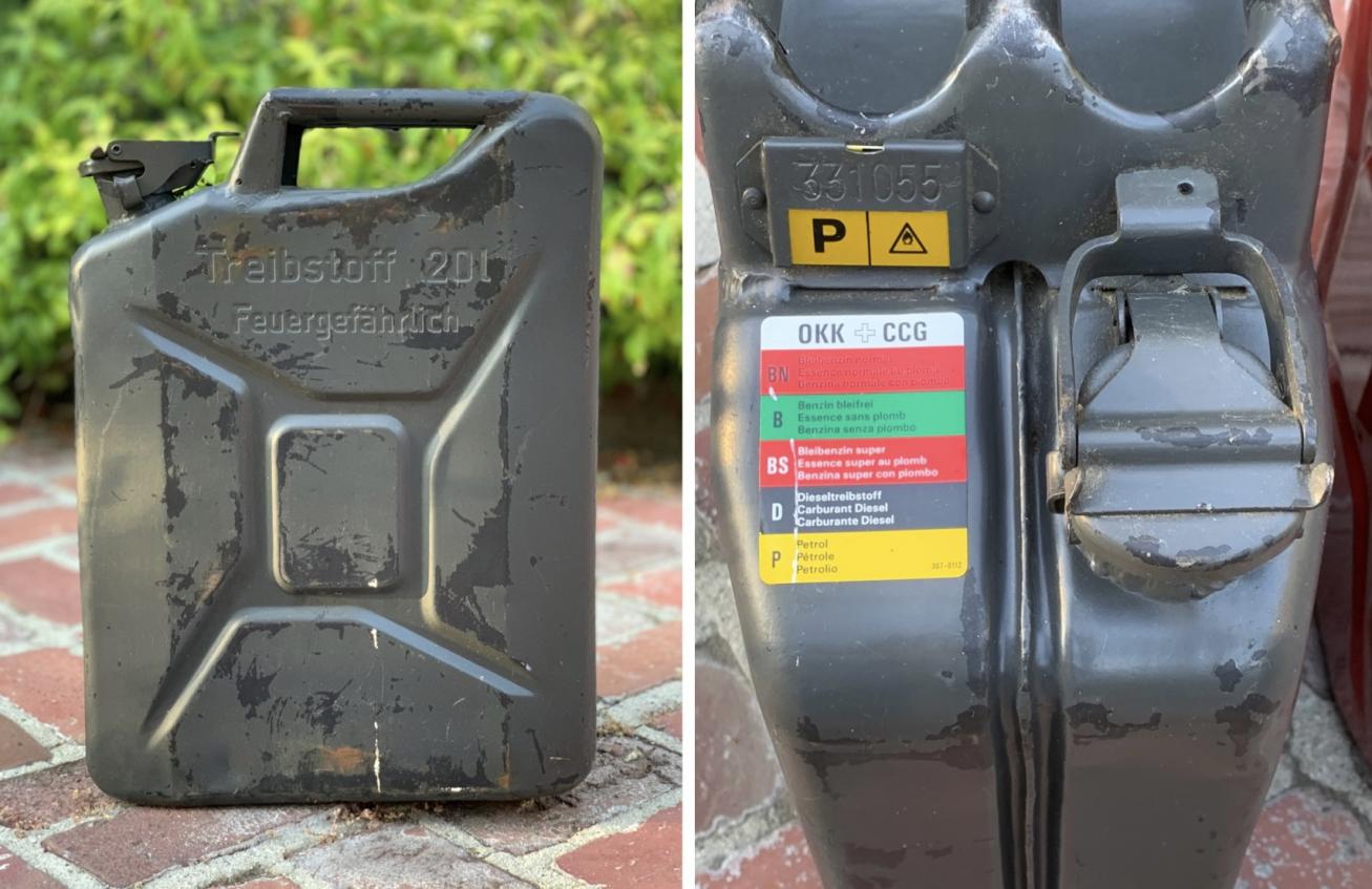

Top Photo: my first Jerrycan purchased surplus on 1985. Detail: the label can be changed depending on what fuel,is stored in the can.

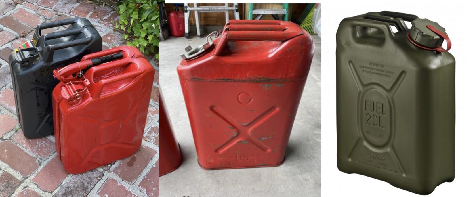

Next:OG and Valpro NATO-style cans, the Blitz can, and the military version of the Sceptre can.

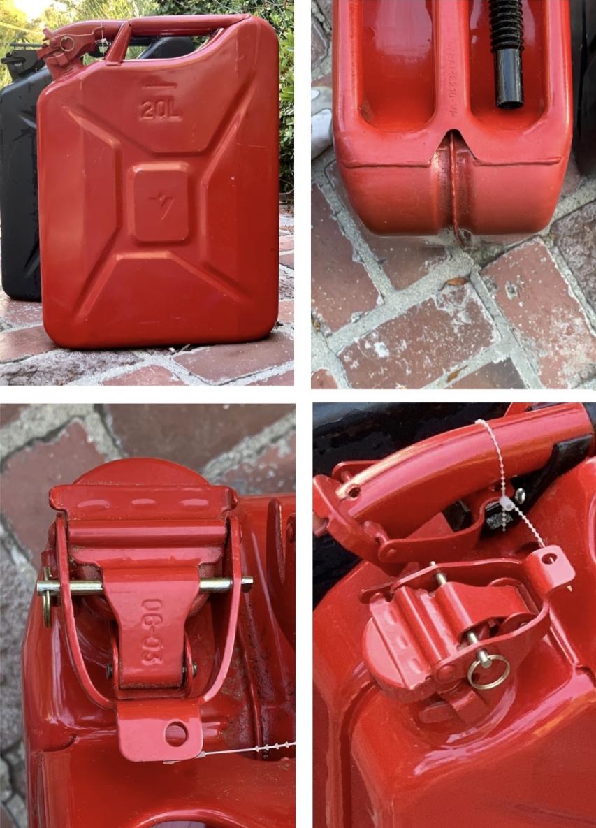

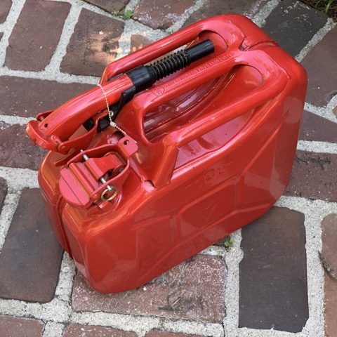

Next: 4 photos of the Wavian/Valpro can, with details of the cam-lock lid. Note the stamping of the date on the hinge. Also note the detail of the recessed welded seam.

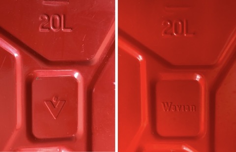

Finally: Valpro and Wavian logo stampings.
