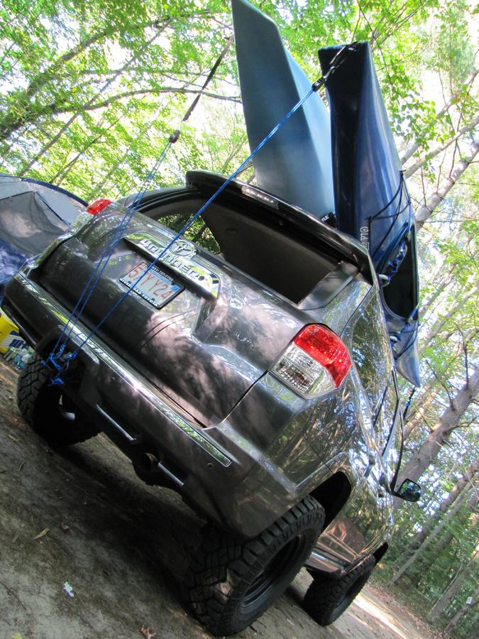

I got a couple of 12' fishing kayaks for my wife and I the other day, and with the way I rigged it up the first time, it would be nearly impossible for her and I to load and unload them away from home by ourselves. Does anyone have any suggestions on a better way to rig them up there? My rack is a Thule with 2 stacker attachments in the center of each crossbar. i was thinking that maybe I could lay them flat on the hull, but the sides of the kayaks would be hanging over the sides of the crossbars, and i'm not sure if that's kosher while driving. This is the first time strapping anything to the roof of my vehicle, and actually the first time having a vehicle that I could actually strap anything to.
This is how I put them up the first time

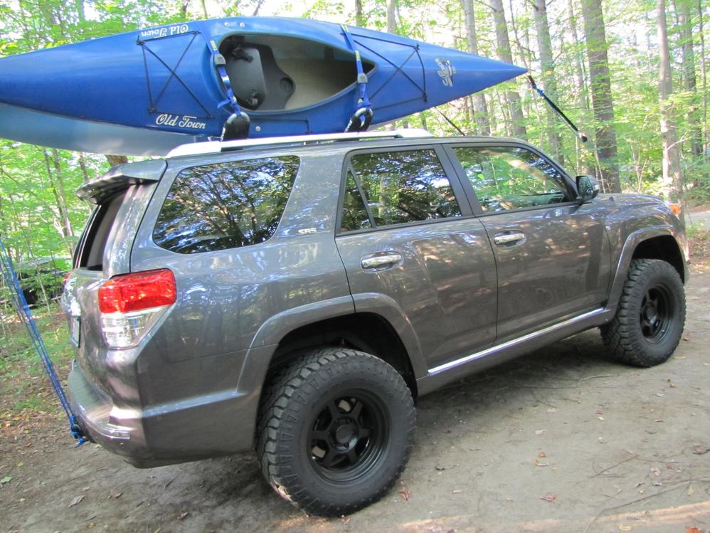

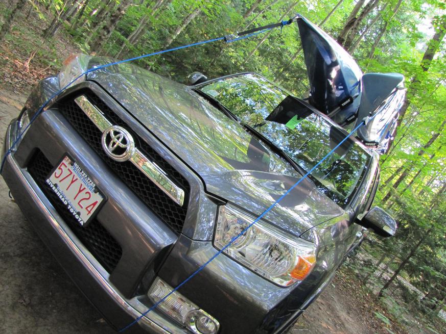

Old pic of the truck but this is how I run mine. These Old Towns are heavy even with two people. I need to bring a step ladder along as well.

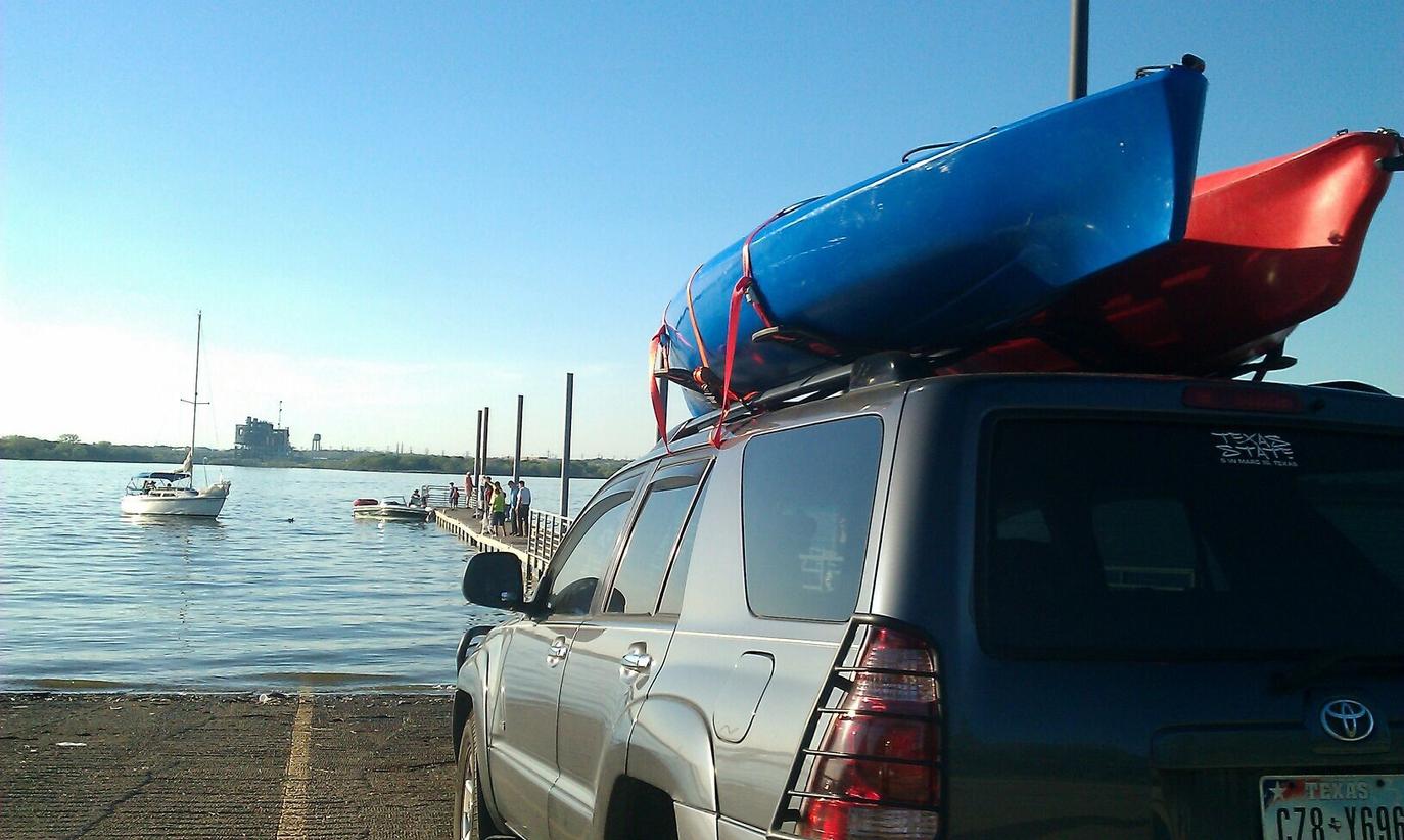

Hauled kayaks around for years. Ive had 4 on top of my Honda accord and 7+ in the back of our old pickup. I go with the longest bars they (Thule/Yakima) offer and lay your kayaks flat (bottom up). From the picture you're look like a flatter more aerodynamic version vs the old yakima bars used to be just a round pipe which we would get close to the same thing at home depot. Get the good straps, not a harbor freight variety and I like to just use two straps around the kayaks and the outside loops around the tower. On longer trips I'd use a third nose strap. the picture is from a long trip down to south florida.
Also, we bring a small step ladder makes loading way easier on a lifted vehicle.
