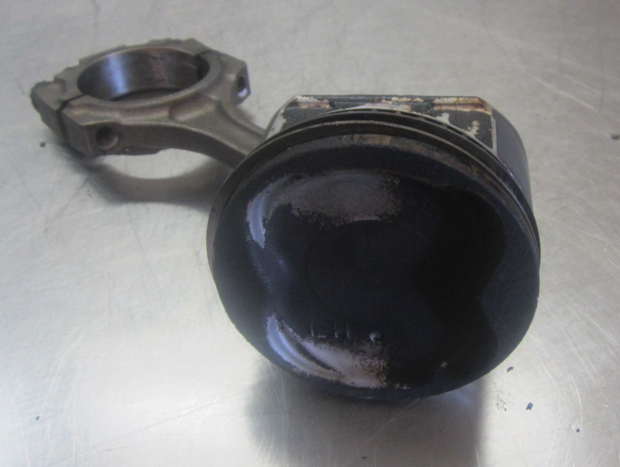

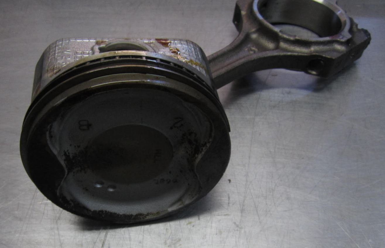

The 06+ has a double valve relief on the piston top while the early v8's do not. The early 05 that I own had a funny TRIPLE relief that I could not match with any other piston I could find. I actually don't have a picture of that because I ended up using the same piston with a new rod from an 03 truck.
