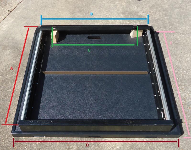

[MENTION=105481]3wbdriver[/MENTION] can you return flavor by providing some dimensions?
A to E?
And the thickness.... ie. from the original cargo floor to the top of the tray
A. 34"
B. 34 1/2"
C. 2 slotted holes approximately 25 1/2" apart at back of frame (door).
D. 40"
Height from floor. 6"
The deck itself measures 40" W x 35 1/2" deep.
There are 2 outward facing bolts on each side near the corners. These hold the drawer rails in place. If needed as anchor points the nuts could be removed and a longer screw could be used to add an anchor bracket. This is IF someone decided to bolt it down. There are also floor plates front and rear that run crosswise that could be used for the same purpose.
With the front rail removed the deck is approximately 2" above the plane of the laid down 2nd row seats, so I don't know if it could comfortably be used as a mattress base or not.

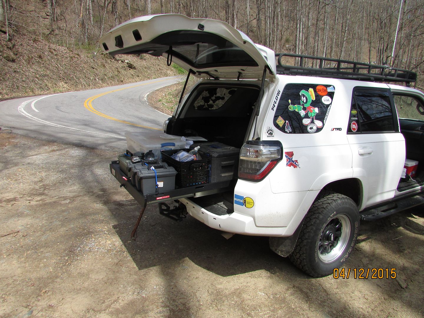

3 days and a little over 800 miles into my trip, and it has been quiet as a dormouse. No problems so far and the straps are staying tight.
Post some pic of your trip as well as your gear in the back.... with the slide out.... heh hee.... quite a lot to ask!! :lmao:
I had reason to use it today. It was much easier getting at my GoPro box which is stowed on the left front of the tray. I just slid it out and stood by the left taillight to get at the box. I have a cabin tent, cot, Kelty tarp in a bag, hanging and bagged clothes, and various storage boxes stowed on the folded down 2nd row seat right now. It all stays put when I slide the tray out. And the tray has been rattle free for 1200 miles so far. The heaviest item you see on there is the tool box on the right front. I prefer to keep the heavier items forward on the tray to reduce strain on the forward tie down straps.
