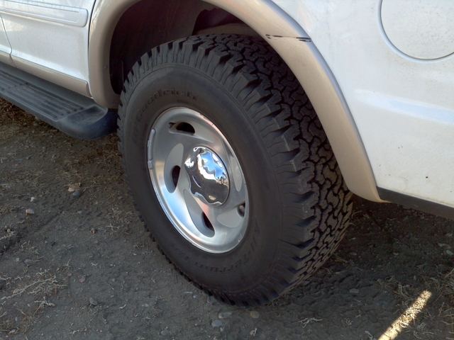

I have BFG 265/75/16 load range D All Terrian KO's on a stock tall 1999 sr5 and I have rubbed the fronts a couple times when the wheels are turned and flexed. It's not bad at all and hasn't happend in a while. It occured when they were new. I'm going back to 265/70/16when these wear out. That will be awhile as I'm getting great mileage. I have 46,000 miles on them and I think I have another 15,000 left in them. No kidding! I rotate them twice a year.

Hi, I have a stock 2000 4 wheel drive 4runner with BFG All Terrain T/A KO LT265-75-R16 with a load range of D. This is my daily driver and I have over 60,000 miles on the tires. I too am a big fan of BFG's and have used them extensively on other vehicles. I'll be needing new tires soon and will either look at these or the Goodyears Duratracs (They look cool). For my needs BFG's have been great and I haven't felt any changes in my ride due to the tires. When I first got them, I did experience slight rubbing just like the others have mentioned, but nothing major. Good luck with what you decide to get and let us know.
