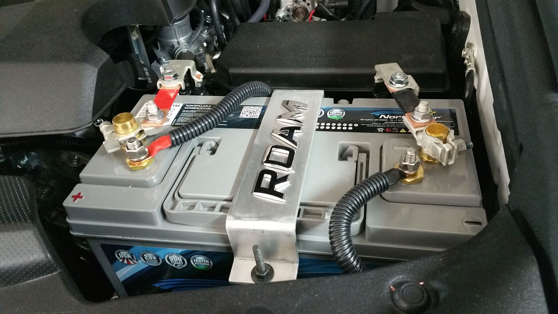

Hi Did you need to add a height adapter? Or did it fit right in? Thinking about purchasing one.
Needed a height adapter for the 34f to work. Had it at the dealer for oil change they tested the batt and they were all like WTF when it came up 1342cca
I don't see a 34F on their site. What's this height adapter you speak of?
