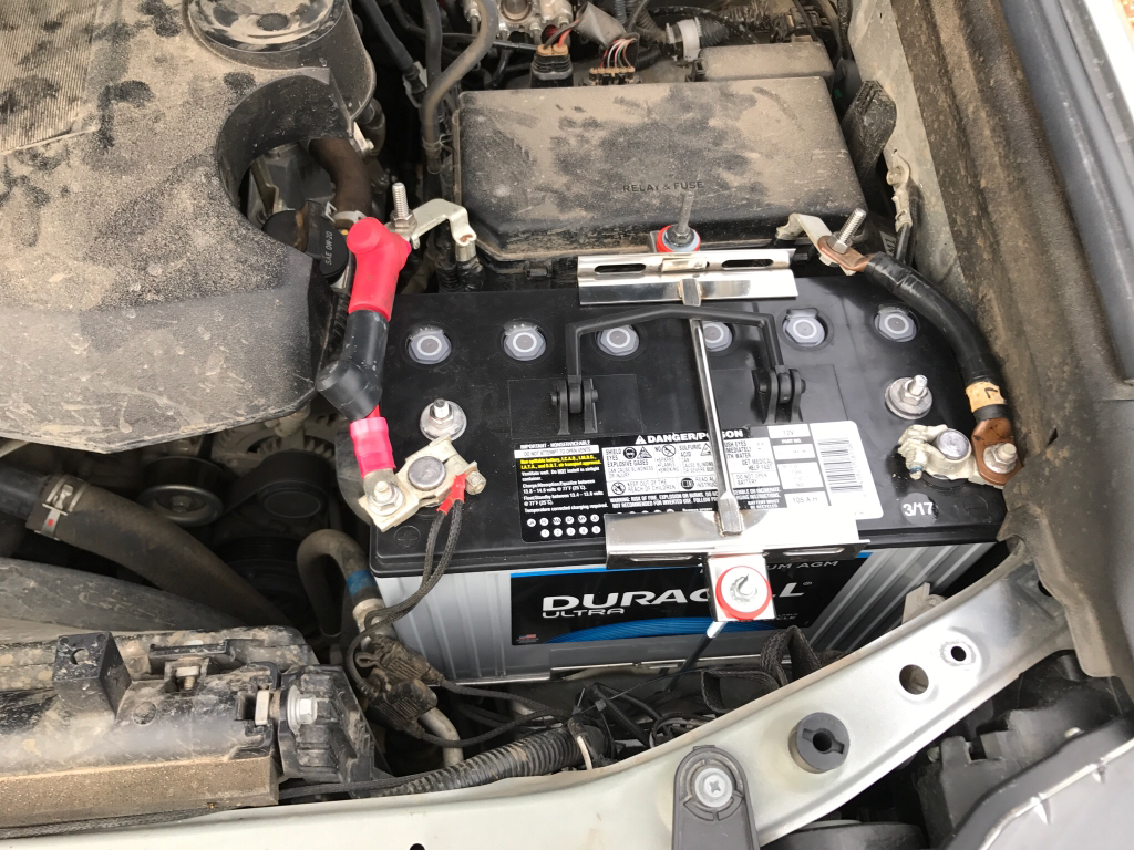

Just installed a Duracell 31 agm at batteries plus (they told me the x2 North Star doesn't come with automotive studs anymore) but I had to use some spare battery cable to get the connection to reach.
I'd like to clean this up - what did you do to extend the connection? Looks like you just have a copper bar?
Any help would be greatly appreciated!
Thanks!!
Thanks!!
This is what I look like currently.
Not trail ready!!
Did you figure out a way to bolt down that tray or is it just resting there?

No no. It's bolted in there. Not going anywhere.
I bought the larger tray someone recommended from amazon and it went right in. However instead of nuts to screw on the posts - it came with these huge (tall) t-nut fitting things (you can see it in the picture on the top), and the hood wouldn't close with the front one on. I had to find my own nut.
Mota Performance A70234 Stainless Steel Battery Tray - Universal 13" x 7" https://www.amazon.com/dp/B002ZMKJWU/ref=cm_sw_r_cp_apip_FlwLY14Bt1AT6
The cables that extend the connectors aren't really a good fit. The positive side has more movement than I'd be comfortable with on an extended exp trip.
Was actually reading online about creating a bus bar from Cooper sheeting, cut or folded to fit my needs. Looks like that's what the poster on the first page with the picture of the super clean under hood area and north star battery has done.

To the existing captured nut? I have the same setup but the nut lines up with the rib in the tray. How did you bolt it?

I'm not sure I understand your scenario.
The posts that have a hook on the end - on the top side (towards driver), I'm using the factory hook and factory nut. On the bottom (closest to the headlight) I'm using the hooked post that comes with the tray kit.
The hook part on the post I have placed in the location that the factory hooked posts were hooked into.
Is the tray bolted to the fender? I need to bolt mine down but the existing threaded nut in the fender lines up in a bad spot. I'm curious how you bolted the tray.
I used the factory hook locations instead of the tray, but still want to bolt the tray so it can't rock on the fender (which is what caused some people to crack fenders when they tried to use the plastic tray)

Ahhhh.
I did not bolt the tray. The factory plastic one wasn't bolted so I figured this one didn't need to be. Guess I should!
I would corroborate this info with someone else.
Circling back - I was able to pick one up last weekend, so they were mistaken or misleading you. Now I need to find the most reasonable and safe way to extend my cables. I've seen a few but still at a loss as to which is right...
