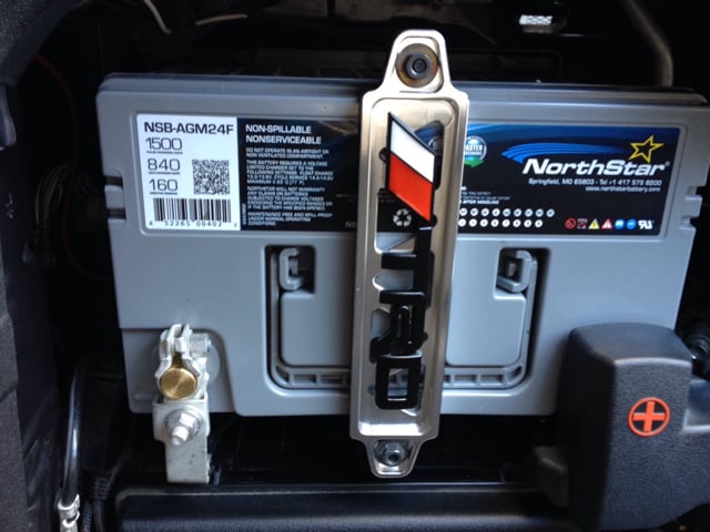

I was looking into the Northstar as well, how do you like it and what did you have to do to make it fit?

Northstar also makes the X2 batteries at Batteries Plus
