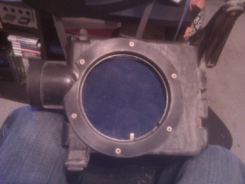

Here is a pic of his...
:barf:
i ordered a 5" last week and dont like it. I feel its too big. I already did a 5 inch hole cut out though. I just left the hole. the 4" is real clean looking.
